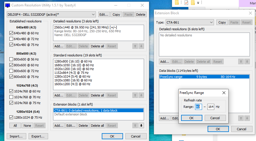

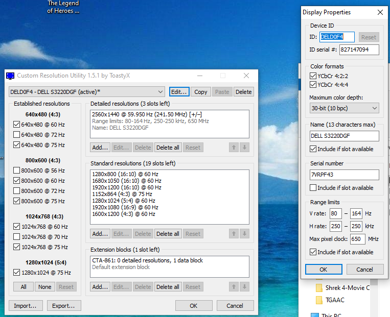

(08-15-2021 04:31 PM)MasterofSalt Wrote:  Hello, 6900 XT with a Dell s3220dgf freesync flickering issue. One of the fixes is to set the freesync range to 80-164 from 48-164. However it does not appear to be working. Range remains 48+, connected via DP port, and set V range via both "detailed resolution" (which weirdly shows the current refresh rate at 59.950, even with the monitor and drivers both telling me its at 164 Hz) and via the Extension Blocks. Any ideas?
I don't understand what you're saying. The lower end of the FreeSync range isn't set with a detailed resolution, and CRU doesn't show the current refresh rate. The FreeSync range for DisplayPort is set using the range limits (use the "Edit..." button at the top).
Please see pics attached. Tried both setups separate and together, and on each of the 3 entries for my monitor (only one listed as active).
I didn't think the detailed resolution showed the active setup, but wanted to let you know just in case.
08-17-2021, 07:19 PM
Post: #6015
(08-17-2021 06:52 PM)MasterofSalt Wrote:  Please see pics attached. Tried both setups separate and together, and on each of the 3 entries for my monitor (only one listed as active).
Well something is wrong because it shouldn't show "Default extension block" in the list with an AMD GPU. Run reset-all.exe and restart. Is CRU is able to read the extension block after that?
08-17-2021, 07:46 PM
Post: #6016
It's still there, but now there is only 1 entry per monitor not 2 for the secondary and 3 for the primary... I can select Delete on "default extension block"...

08-18-2021, 01:37 AM
Post: #6018
(08-17-2021 07:46 PM)MasterofSalt Wrote:  It's still there, but now there is only 1 entry per monitor not 2 for the secondary and 3 for the primary... I can select Delete on "default extension block"...
I don't know why it's not loading the extension block, but I have a copy that you can import with the range changed to 80-164 Hz:
.dat  DELD0F4.dat (Size: 985 bytes / Downloads: 737)
