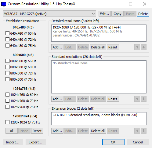

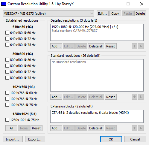

(01-25-2022 05:57 PM)ToastyX Wrote:
(01-25-2022 02:29 AM)lanec2035 Wrote:  I just recently switched my monitor set ups as I am working from home. I have my desktop plugged into 2x MSI Optix G273's. One is on DP and one is on HDMI through a KVM. I have an NVIDIA GeForce GTX 1070.
I can get things set up alright, but when I use the switch to go to my other input and then back to my desktop my desktop acts like it is a new display all together and just stays blank.
Any tips on getting it to pick up the monitor as being the same one I have put in settings for?
If it thinks it's a new display, why would it stay blank? That seems like a fault with the KVM. You probably need an HDMI switch with EDID management.
KVM works fine without CRU running. Just have the EDID issue that I hate having to rearrange my windows every time I use my switch.
I am not sure what I did differently, but I reapplied my settings that I used yesterday and did not get the issue I described before, but am getting the same results I was without CRU. When I use my switch it moves everything to the one display.
01-26-2022, 04:26 AM
Post: #6344
(01-26-2022 02:56 AM)lanec2035 Wrote:  KVM works fine without CRU running. Just have the EDID issue that I hate having to rearrange my windows every time I use my switch.
That isn't what you said the first time. Windows doesn't think it's a new monitor. Windows moves the windows to the other monitor when the monitor disconnects because if it didn't, how would you access the windows on the disconnected monitor? CRU does not emulate monitors, so it can't prevent this from happening. The answer is still the same. You need a switch with EDID management so Windows thinks the monitor is still there when you switch away. There are also cheap dongles you can use instead that will transmit an EDID even when the monitor disconnects. Example: https://www.amazon.com/dp/B07YMS18T7/?tag=mtests-20#ad
