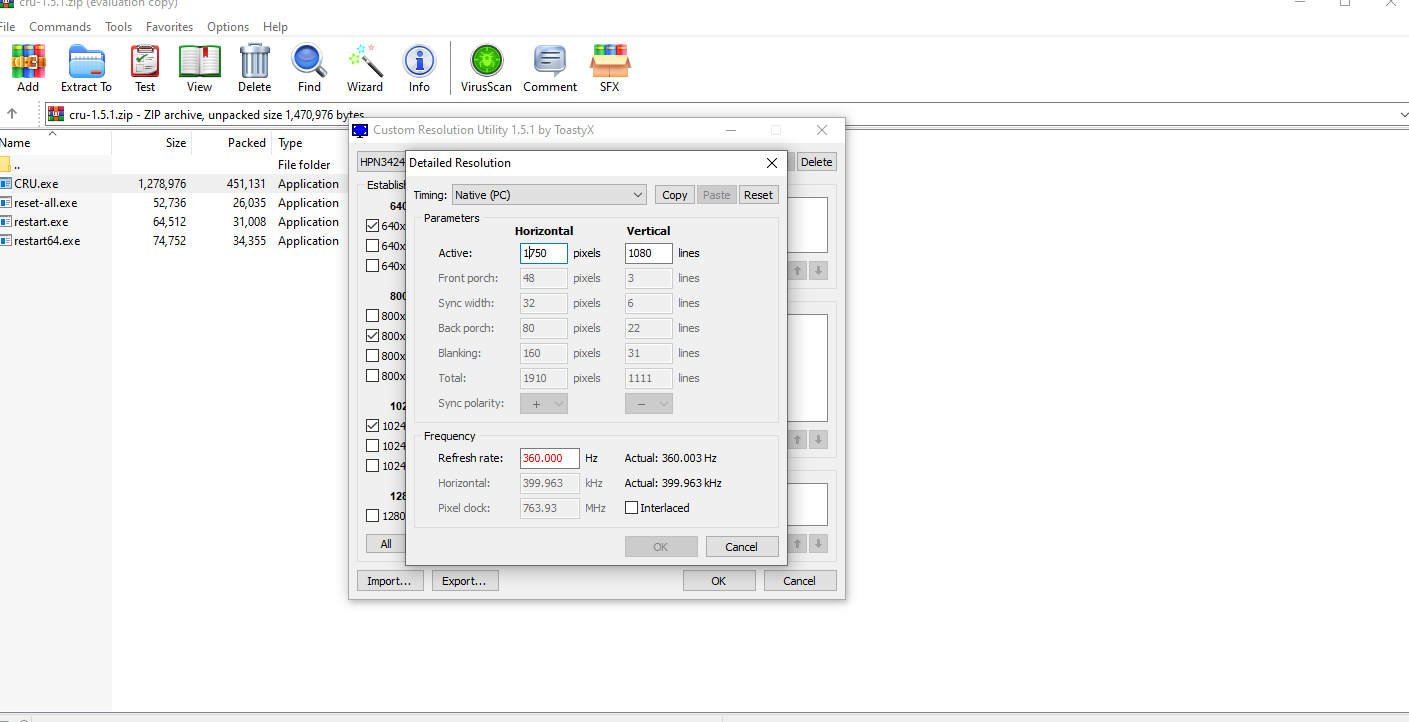

Hello everyone ,
Today tried to put my custom resolution as native 1750x1080 on 360 hz
But it wont work for me , the number of hz just turns red and i cant press ok .
What is the problem ?Huh

(02-02-2022 11:16 PM)thickboy69 Wrote:  Today tried to put my custom resolution as native 1750x1080 on 360 hz
The problem is you don't read.
What do i need to read???
02-03-2022, 08:26 PM
Post: #6376
The 1st post
Quote:EDID detailed resolutions are limited to 4095x4095 and 655.35 MHz pixel clock. If a value turns red, that means it's invalid or out of limits. Use a DisplayID extension block to add resolutions with higher limits.
And also explained few posts before
