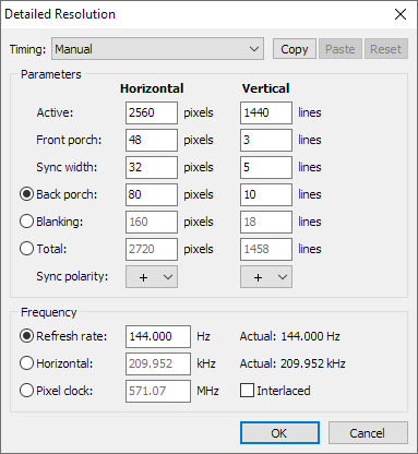

  • 144 Hz at 10 bpc might be possible with DisplayPort 1.2 if you edit the detailed resolution (might be in the extension block) and reduce the blanking/totals to keep the pixel clock below 576 MHz (with some overhead it might be 572 MHz).

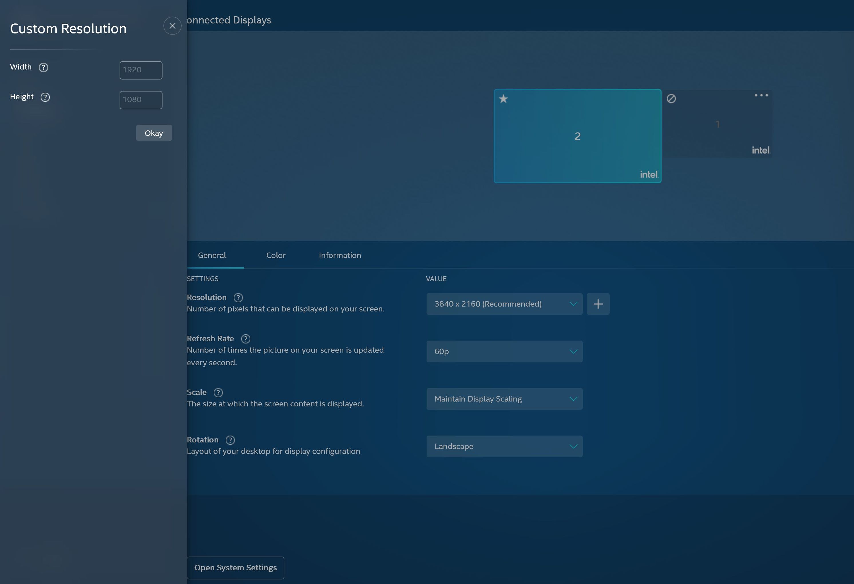

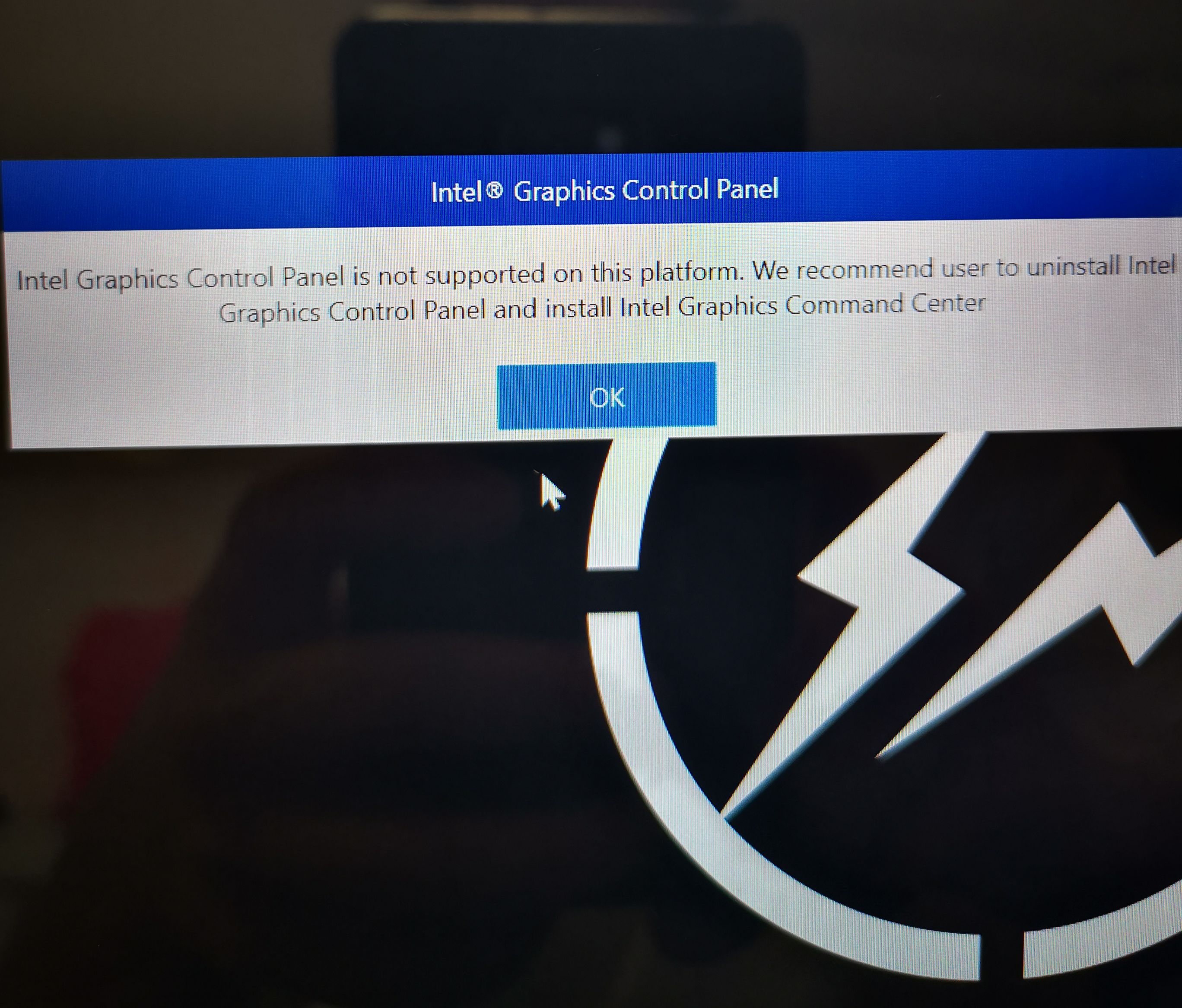

And from laptop I can only push native 4k@60 only but can't override to 4k@120. If I would have that old intel control center where I could set even refresh rate and monitor timing standard, I would have 4k@120
And as you guessing I am not able to push custom resolution because amazing intel scrapped traditional graphics control panel from right click .. Only my option was to download microsoft store app intel graphics command center . And that poor center surprised me and when I tried to do custom resolution, it only showing width and height and can't do anything.
So I was trying to workarounds in registry adding some strings as on youtube some managed to do it, but no luck for me...
Intel shamefully removed old control panel where I could be able to do full custom resolution.

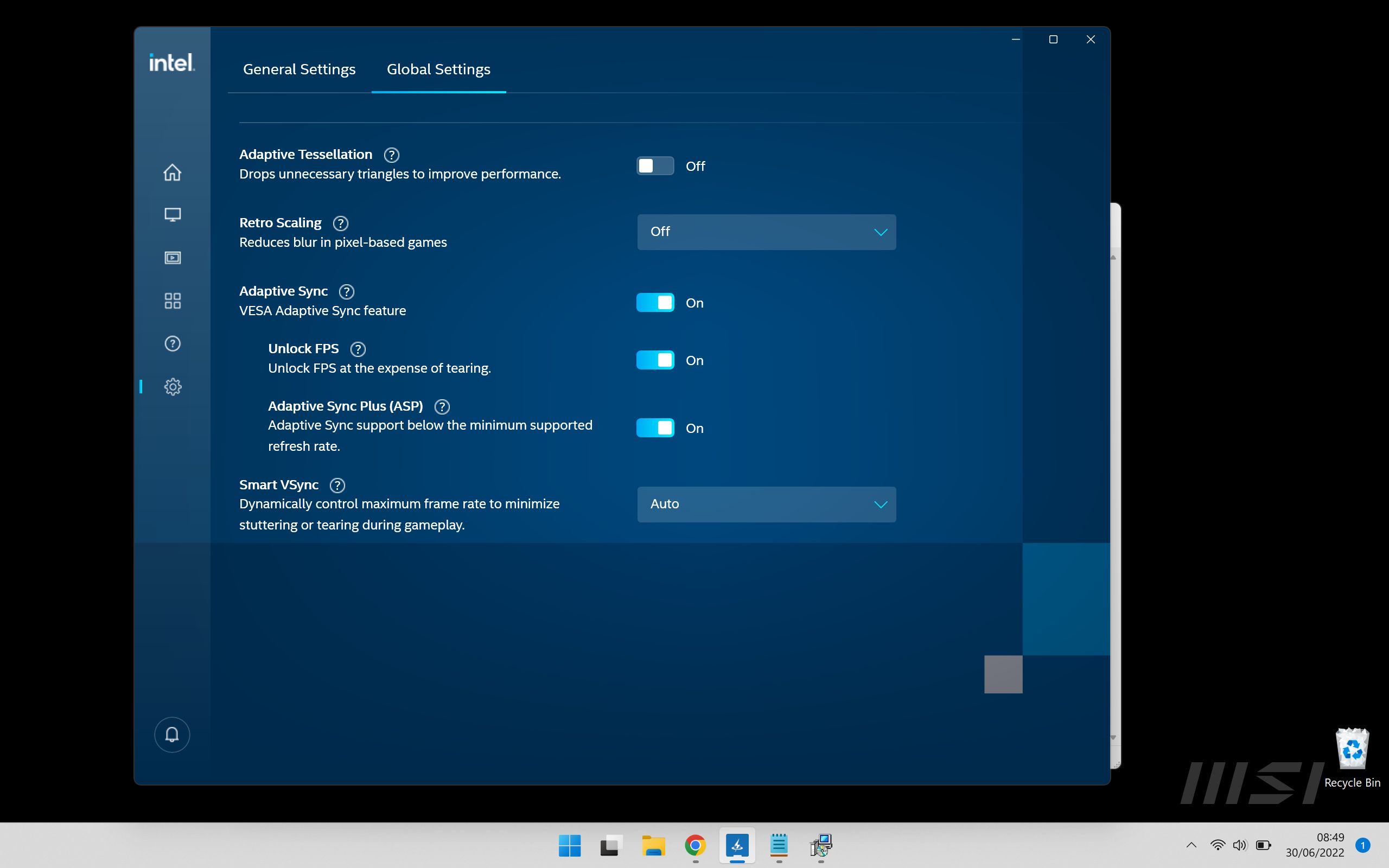

Is there any way we can enable "Dynamic Refresh Rate" on Windows 11 using CRU? I'm using a laptop with Intel 12700H with onboard GPU and RTX 3060, outputing to a 165Hz display.
06-30-2022, 08:03 AM (Last edited: 06-30-2022, 08:04 AM by IIISi Z16 HF LE)
Post: #6709
(06-30-2022 06:07 AM)cluelessguy Wrote:  Is there any way we can enable "Dynamic Refresh Rate" on Windows 11 using CRU? I'm using a laptop with Intel 12700H with onboard GPU and RTX 3060, outputing to a 165Hz display.

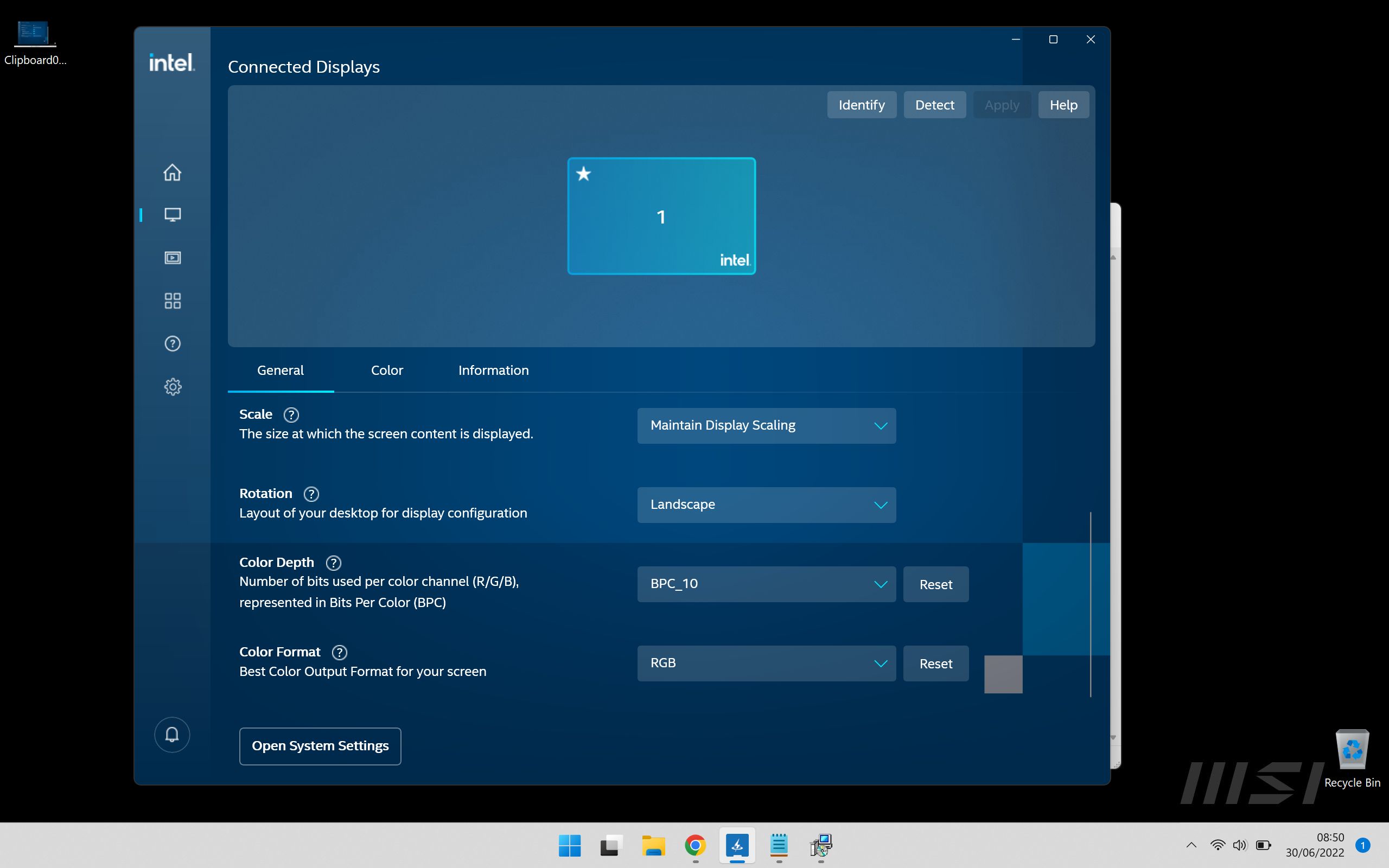

Open Intel graphics command center click on gear - settings then on top window select global settings and you have all stuff there ...
I have IIISi Creator Z16 Hiroshi Fujiwara Limited Edition laptop with intel i7 11th gen 11800H and RTX 3060 And 165hz refresh rate mini LED screen with Full HDR support 1000 nits screen is amazing !
Also check in video settings scroll down and see if you have set 10 bit color depth and color formal RGB .. I think default is only 8 bit .. with HDR off . With HDR on it will auto switch to 10 bit but I have 10 bit even with HDR off.

In intel command center, when I click on + next to resolution, it won't give me all full options to set custom resolution which is strange ...
