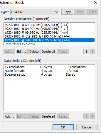

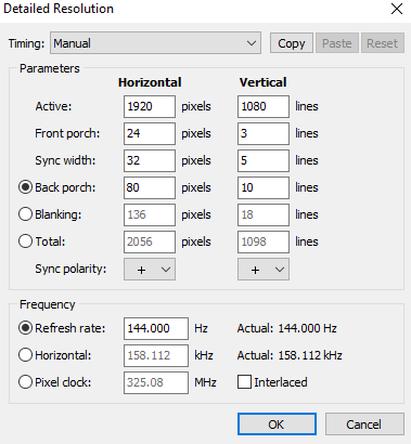

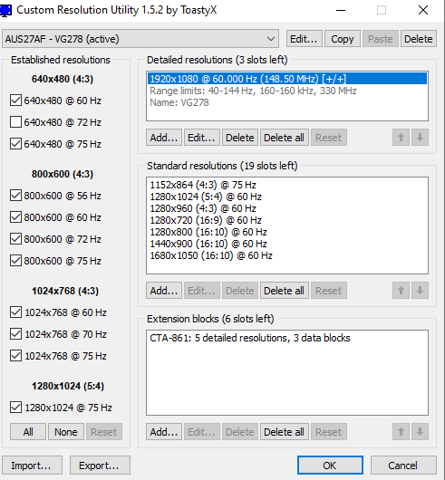

I have an issue seemingly with a wrong refresh rate (but maybe i misunderstand the tool)
This is my monitor:
https://www.asus.com/displays-desktops/m.../techspec/
It shows 60 hz instead of 144 Hz. I added 3 images with what i see. This is wrong, do i have some wrong settings or what is going on, can you help me understand this. I did not edit anything yet its the first time i opened the utility and it displays this info. The monitor is reporting 144 Hz though to be honest something seems off, playing at 60-100 Hz looks so bad it seems like 30 and bellow. Wondering if I didnt mess up something some time ago and the monitor got stuck with some wrong settings
Appreciate all the help if anyone has any ideas

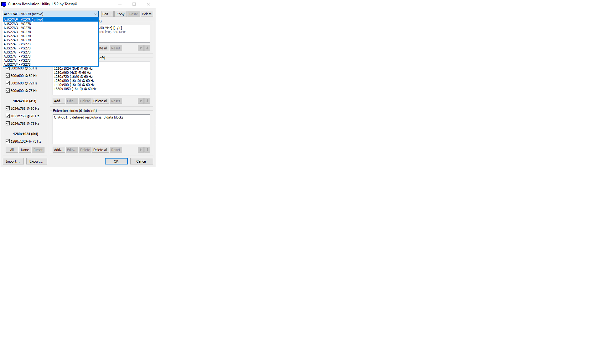

Also can i delete those? Why are there so many entries, are they from old plug and play actions that were saved in registry or something?

(04-12-2023 09:53 AM)endao2 Wrote:  It shows 60 hz instead of 144 Hz. I added 3 images with what i see. This is wrong, do i have some wrong settings or what is going on, can you help me understand this. I did not edit anything yet its the first time i opened the utility and it displays this info. The monitor is reporting 144 Hz though to be honest something seems off, playing at 60-100 Hz looks so bad it seems like 30 and bellow. Wondering if I didnt mess up something some time ago and the monitor got stuck with some wrong settings
I don't see a problem. Your screenshots show 144 Hz is in the extension block, and you even highlighted it. If you're using a refresh rate supported by the monitor, then any performance issue is usually on the GPU's end, not the monitor.
(04-12-2023 09:53 AM)endao2 Wrote:  Also can i delete those? Why are there so many entries, are they from old plug and play actions that were saved in registry or something?
https://imgur.com/wqtz7Be
Every connection to every port and even different drivers can cause a new entry to appear. You can remove all of them. Active entries are automatically recreated after rebooting or running restart.exe. Running reset-all.exe and rebooting will remove everything and reset the active entries. Running restart.exe can have the side effect of creating a second entry because of the basic display driver, but that isn't used.

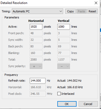

If I may ask a different question. I have the GPU memory locked at max freq (2000Mhz in my case) and also dealing with some input lag (some gpu drivers way worse than others) and I am thinking to use another mode to see if GPU memory will go down
I found that some people fixed this using a different timing. Is there a risk running pixel clock at 346 vs the max reported(330 in my case)? I attached what it looks like if i chose that timing. Am I understanding correctly that the monitor is being instructed by the OS on how to operate by altering the registry? Or its a gpu driver change as well?
Also would this have an impact of how fast the image is being displayed right? Could this add / remove some perceived input lag? I'm troubleshooting Rocket League and its a very fast paced game

(04-13-2023 07:17 AM)endao2 Wrote:  If I may ask a different question. I have the GPU memory locked at max freq (2000Mhz in my case) and also dealing with some input lag (some gpu drivers way worse than others) and I am thinking to use another mode to see if GPU memory will go down
If this would fix the gpu memory issue with no impact in games it would be nice
If you're using DisplayPort, then 346 MHz is fine. Technically more blanking means it spends less time visibly refreshing and more time between refreshes, but the difference is miniscule and not worth worrying about. CRU creates EDID overrides in the registry, which is basically a description of what the monitor supports. It's not really altering anything in the registry since there's no override by default. The GPU driver will use the override if it exists. Otherwise it uses the monitor's EDID.
