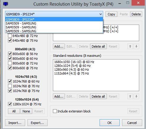

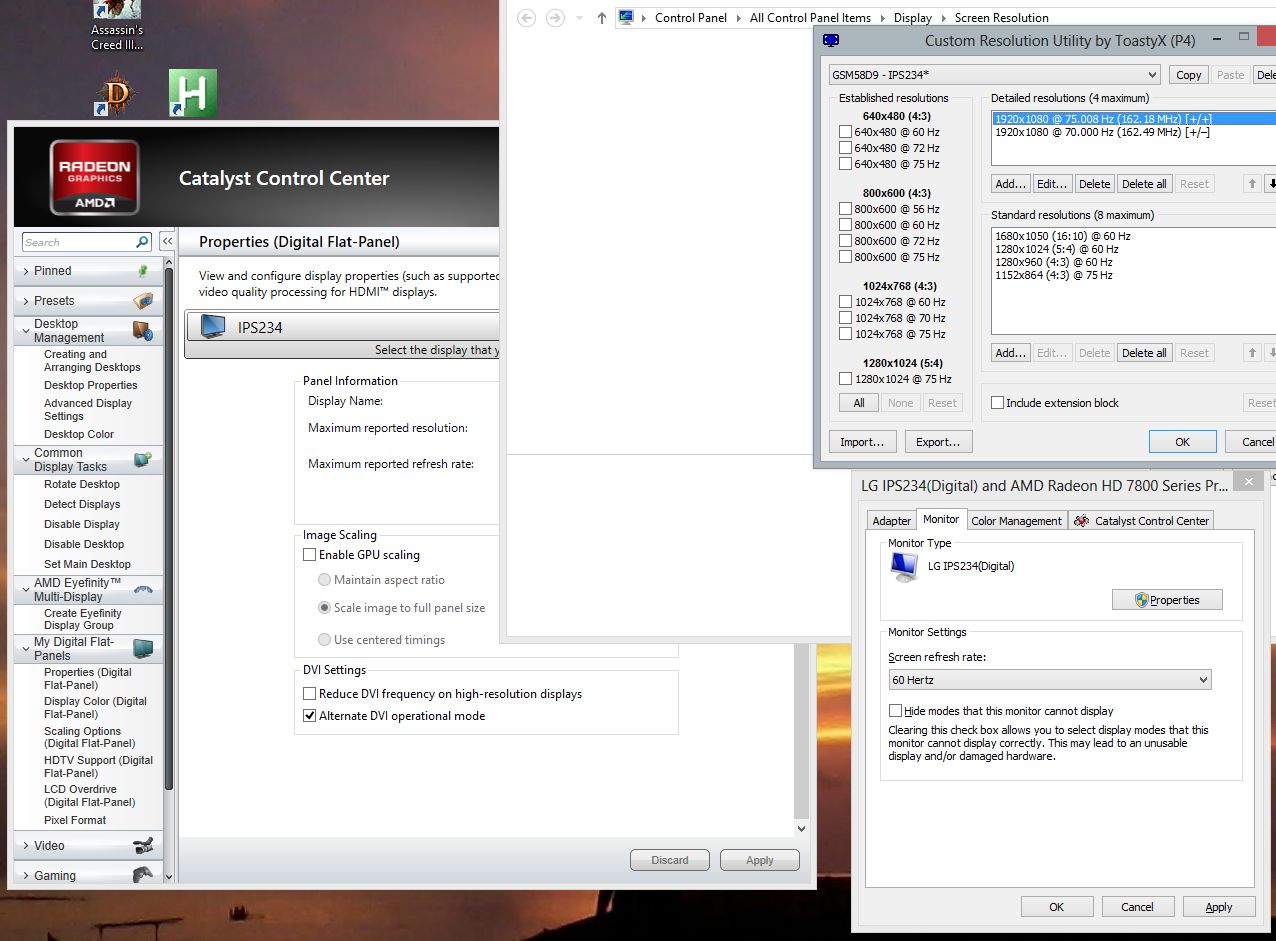

02-07-2013, 10:54 AM (Last edited: 02-07-2013, 06:09 PM by techhit)
Post: #27
Hi.
First of all. Just wanted to thank you for making this app. I've been using your CRU utillity perfectly up until tonight where I thought I'd try the ATI Catalyst 13.2 Beta drivers, after which point, I could no longer use my custom resolution of 1920x1080 @ 75hz anymore. So I uninstalled 13.2 beta, and reinstalled 13.1, and no matter what I still cannot get 75hz @ 1920x1080.
I've checked all the usual settings that I've been able to get this working in the past.
- Run CRU.exe as Administrator (then reboot).
- Deleted the custom resolutions and re-added them.
- Ensured "Alternate DVI mode" is ticked (also tried unticking).
But no joy. Would appreciate any advice. Thanks.
02-07-2013, 12:10 PM
Post: #28
Are you choosing the correct entry from the monitor drop-down list? Sometimes installing a new driver version will create a new entry, so you'd have to copy the settings over to the new entry.
Usually the entry is marked as "(active)" in the list, but I don't see that in the screen shot. I need to come up with a better way to detect which entries are active.
If you're not sure which one it is, you can delete all the monitors in the list, then reboot. Connected monitors will be detected during boot.
02-07-2013, 12:20 PM
Post: #29
(02-05-2013 06:19 PM)alientorni Wrote:  dsub cable is "with ddc" and dvi adapter is DVI-A (analog only). strange :/
That's fine. Is the monitor listed as "Generic non-PnP monitor" in the device manager?
02-07-2013, 05:53 PM (Last edited: 02-07-2013, 06:07 PM by techhit)
Post: #30
(02-07-2013 12:10 PM)ToastyX Wrote:  Are you choosing the correct entry from the monitor drop-down list? Sometimes installing a new driver version will create a new entry, so you'd have to copy the settings over to the new entry.
Hi. Thanks for the reply. Yes there is only one entry for my monitor (LG IPS234v). There are 3 other entries for my Samsung TV connected via HDMI
I deleted the IPS234 entry and re-added my custom resolution, but that hasn't worked either.
