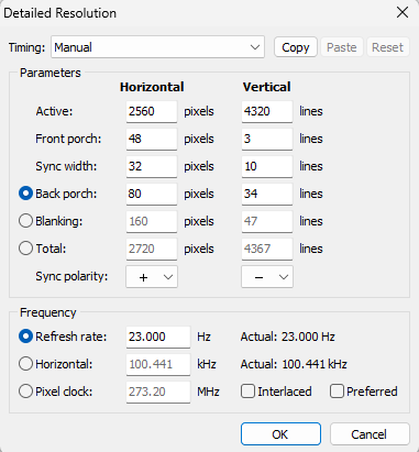

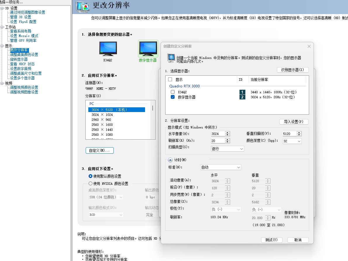

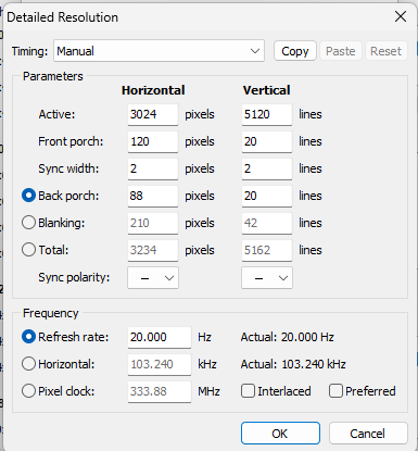

Hi, I'm trying to set up a custom resolution for a 3024x5120 (10k) monochrome transparent lcd - these screens are built for 3dprinters but I'm attempting to use this one in a photographic enlarger. I have some parameters (for rasberry pi setup, in chinese :/) from the manufacturer, and I have managed in the past to get a similar screen working - but I can't seem to make this one work. My machine has APU
AMD Radeon 760M Graphics.
I'm not at all experienced with setting this stuff up - so probably I have made a simple error or misunderstood how it's supposed to work Wink Any assistance wouldbe greatly appreciated.
manufacturer setup:
what I'm attempting in CRU DisplayId 1.3 extension block:
I'm pretty sure the other screen worked fine after I set up this DisplayId 1.3 extension block:
Thanks, David.

…and I managed to get it working - multiple resets and reboots and finally it worked Smile
(03-23-2026 07:09 AM)dpattinson Wrote:  Hi, I'm trying to set up a custom resolution for a 3024x5120 (10k) monochrome transparent lcd - these screens are built for 3dprinters but I'm attempting to use this one in a photographic enlarger. I have some parameters (for rasberry pi setup, in chinese :/) from the manufacturer, and I have managed in the past to get a similar screen working - but I can't seem to make this one work. My machine has APU
manufacturer setup:
Thanks, David.
