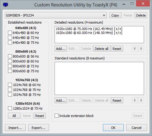

(02-07-2013 05:53 PM)techhit Wrote:  Hi. Thanks for the reply. Yes there is only one entry for my monitor (LG IPS234v). There are 3 other entries for my Samsung TV connected via HDMI
I deleted the IPS234 entry and re-added my custom resolution, but that hasn't worked either.
I can't think of why that would happen. If you deleted the monitor from the list and it was added back in after rebooting, then that should be the correct entry.
Can you try it with just 75 Hz and 60 Hz? Here is a file you can import: http://www.toastyx.net/ips234.bin
If that doesn't work, try uninstalling the monitor from the device manager and reboot, then try again.

02-08-2013, 04:13 AM (Last edited: 02-08-2013, 04:15 AM by techhit)
Post: #33
Hi, ToastyX.
I did as you instructed (see attached), and it still doesn't work. Is there anything else I can check?
02-08-2013, 07:04 PM
Post: #34
I've finally fixed it by doing a System Restore and uninstalling the monitor driver and deleting/recreating all the entries in CRU. Thanks, ToastyX.
