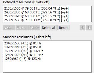

AMD Radeon™ HD 6870. I attached the resolutions I was able to run in a file. All of them work smoothly.
After setting the resolution to 2560*1920@60 (399.35 Mhz) I used PowerStrip (because the AMD 60xx series is the last supported by it -- newer ones can not be tweaked in advanced hardware mode) to increase the refresh rate still higher. I was able to attain around 62 Hz refresh (over 410 Mhz pixel clock). When increased beyond that the screen went black.

08-18-2015, 11:03 AM
Post: #1572
I also have a question. In description (post No.1) you say:
"NVIDIA does not support more than 8 standard resolutions."
Does AMD support more? Because I'm only able to use 8 slots.
08-18-2015, 04:10 PM
Post: #1573
(08-18-2015 11:03 AM)Nazar Wrote:  I also have a question. In description (post No.1) you say:
Yes, but you need empty detailed resolution slots to add more than 8 standard resolutions. Each detailed resolution slot can hold 6 more standard resolutions. You can add up to 6 more detailed resolutions with a custom extension block.
08-18-2015, 04:44 PM (Last edited: 08-18-2015, 04:50 PM by Nazar)
Post: #1574
(08-18-2015 04:10 PM)ToastyX Wrote:  Yes, but you need empty detailed resolution slots to add more than 8 standard resolutions. Each detailed resolution slot can hold 6 more standard resolutions. You can add up to 6 more detailed resolutions with a custom extension block.
I tried this and it works. Wonderful! Thank you so much! Also added some resolutions with the custom extension block. Now all my favorite resolutions fit into one .INF file (because previously I had one with extra high resolutions and another with adjusted higher refresh rates for more common resolutions, like 1600*1200, 1920*1440 and 1280*960).
Now I have one more question. When I use the Catalyst tray icon to switch between the resolutions (one click switching), there's something special about what kind of refresh rate is being automatically used for the new resolution. And I figured out that it somehow depends on the order in which the detailed resolutions are described in the CRU (and consequently in the .INF file).
For example, when I have the 1920*1440@88 (which is the first, or recommended resolution in my detailed resolution list) and then I one-click switch it to 1280*960, the refresh rate remains at 88 Hz and the monitor just displays this new 1280*960 picture as a smaller square in the center of the screen with black borders around. Although, I do have detailed resolution description for this which defines it as 1280*960@130Hz. But in order for this to work, I need to go each time to the advanced display properties and manually select this higher refresh rate of 130 Hz. Then the screen becomes full, black border disappears and it works at 130 Hz.
However, if, for example, I have 1600*1200@104 (which is my second detailed resolution in the list), then the one-click switching works fine and when I select the 1280*960 from the Catalyst tray icon, the display automatically goes to 1280*960@130 without any further manual actions on my side. It also displays full screen immediately.
I was experimenting with this and figured out that this behavior of how one-click switching works depends on the order in which the detailed resolutions are listed.
For example, if I put the 1600*1200@104 as my first (recommended) detailed resolution, then one-click switching from this to 1280*960 will also keep the 104 Hz (with black borders around and smaller screen) and won't go to the 130 Hz which it should as per definition of the 1280*960 in my list.
Could you please explain more about the mechanics of this and why it happens and whether it is possible to achieve smooth one-click switching between all resolutions, where the display would automatically pick up the defined preferred refresh rate?
