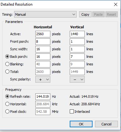

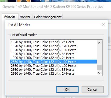

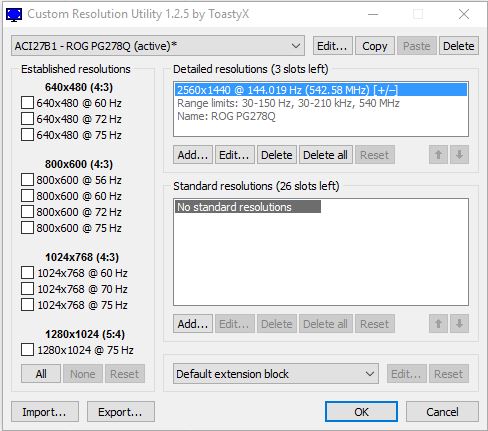

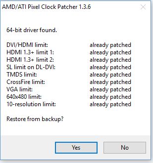

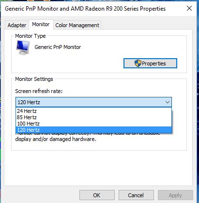

I have been trying to resolve this for a while and hope someone can help.
I have used the following tweak in windows 8.1 to force 144Hz on my Asus Rog Swift PG278Q / AMD Radeon R295X2 / Displayport. http://rog.asus.com/forum/showthread.php...th-R9-290X After upgrading to Windows 10 there is nothing I can do to force 144Hz. It does not show up in the resolution drop down even after adding it via the latest Clock Patcher / CRU. Again this worked fine in Win 8.1 Any ideas? Thanks! |

(12-20-2015 06:58 PM)roadczar Wrote: I have used the following tweak in windows 8.1 to force 144Hz on my Asus Rog Swift PG278Q / AMD Radeon R295X2 / Displayport.The patch is for DVI and HDMI. It does nothing for DisplayPort. 144 Hz should work out of the box. You shouldn't need to add it manually because it should already exist in the default extension block. CRU can't help if the default 144 Hz isn't even listed. That would be a driver issue that you should contact AMD support about. Your first screen shot shows a range limits descriptor with a 540 MHz pixel clock limit. Did you add the range limits descriptor or was it already included by default? CRU is not supposed to include it by default in this case. |

(12-21-2015 04:19 AM)ToastyX Wrote: The patch is for DVI and HDMI. It does nothing for DisplayPort. 144 Hz should work out of the box. You shouldn't need to add it manually because it should already exist in the default extension block. CRU can't help if the default 144 Hz isn't even listed. That would be a driver issue that you should contact AMD support about. Range limits descriptor was automatically added as the result of the other settings. I figured it was a driver issue, but was hoping there is a way to force it. Thanks for your reply. |
