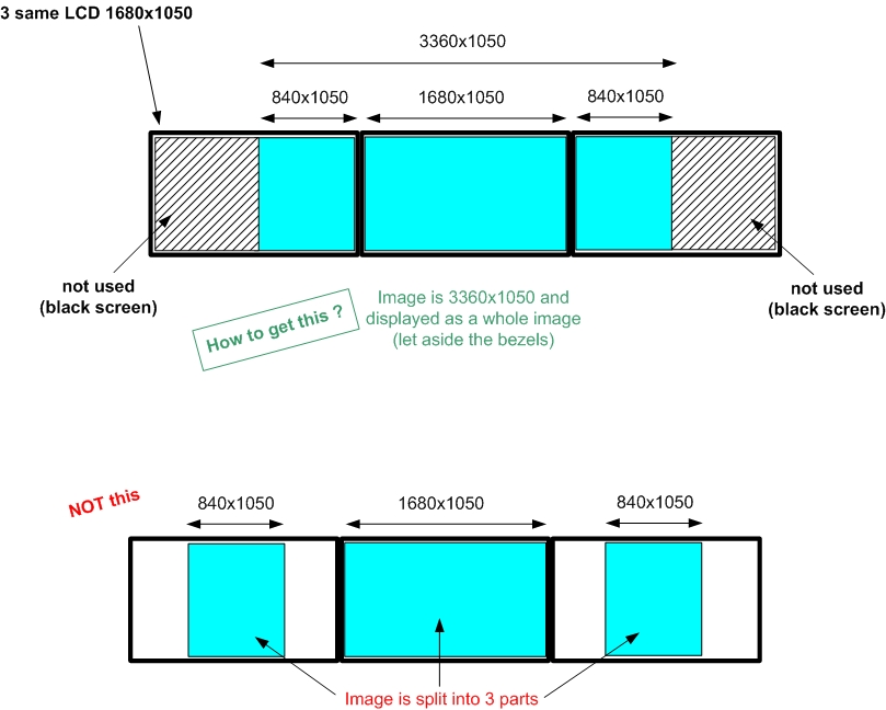

Hi, I am newto the forum and I have a special request.
I have 3 LCD monitors 1680x1050 running Eyefinity. This makes:
- resolution = 5040x1050 (to make thinks easier I do not take into account the bezels widths)
- ratio = 48:10
Is it possible using CRU to make:
- resolution = 3360x1050
.......... 1680x1050 on the middle screen
.......... 840x1050 on the right and left screens
- ratio = 32:10
Please see the attached picture to understand what I'd like to do.
This is a good balance between resolution/ratio/FOV for games. I prefer having this rather than a 21:9 monitor.
My 3 monitors are 22" Iiyama Prolite B2206WS.
I have 2 ATI HD7950 crossfire, Win7-64.
Please tell me whether this is possible or not Smile
Thanks a lot for your help !!

(03-30-2016 07:10 PM)520st Wrote:  Is it possible using CRU to make:
- ratio = 32:10
That's not possible with CRU. CRU can only describe what the monitor can do. It can't control positioning like that. I don't know if there's a way to do what you want.
