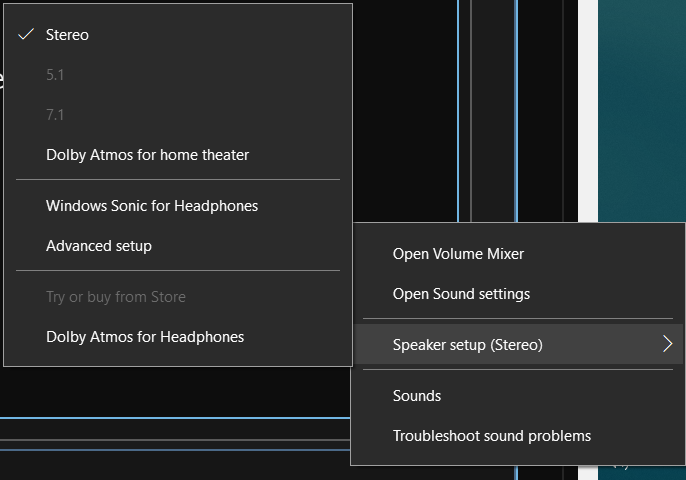

Hi there Toasty! I'm using a EVGA GeForce GTX 1070 to transmit 4k video to a "C7 OLED 4K HDR Smart TV - 65" Class" TV. I have an older receiver (Sony STR-DG510), so the HDMI passthrough doesn't work for 4k 60hz resolution. Therefore, I transmit sound to the receiver via optical cable passthrough from the TV, and I've enabled the "passthrough" option on the TV's sound menu.
Unfortunately, this means that my PC only sees the TV, and only offers me two sound options: Stereo, and Dolby Atmos. When I use Dolby Atmos, the speaker system does play sounds as expected, but there is a substantial delay.
I'm not sure why this happens. I have a suspicion it is because the old receiver needs to decode Atmos down to 5.1 before it can play properly, leading to the delay. If you think this is plausible, how would I use CRU to trick my PC into thinking that the TV supports Dolby 5.1?

(05-18-2018 01:14 AM)notbetterthan_y Wrote:  I'm not sure why this happens. I have a suspicion it is because the old receiver needs to decode Atmos down to 5.1 before it can play properly, leading to the delay. If you think this is plausible, how would I use CRU to trick my PC into thinking that the TV supports Dolby 5.1?
Add AC-3 in the audio formats data block in the extension block.

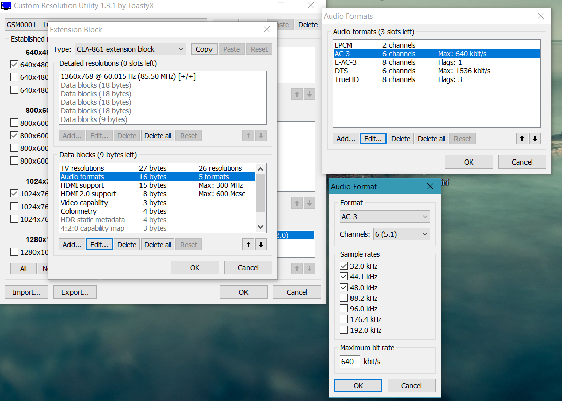

I've tried that - see first attachment. Unfortunately, 5.1 audio is still not selectable (see second attachment).

(05-19-2018 03:05 PM)notbetterthan_y Wrote:  I've tried that - see first attachment. Unfortunately, 5.1 audio is still not selectable (see second attachment).
Did you configure the speakers in the Windows sound control panel?
