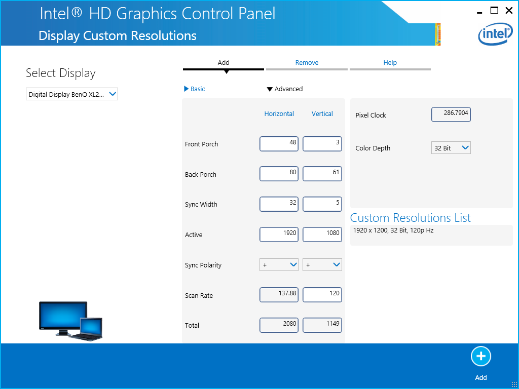

Oh hey, I managed to get the monitor into LightBoost mode with Intel HD graphics, at least on my hardware (XL2420TE, Xeon E3-1245v3, DisplayPort).
I just had to run c:\Windows\System32\CustomModeApp.exe (part of the Intel driver), and add a mode with the correct settings. Original source for the values: http://www.blurbusters.com/?attachment_id=1148 The "scan rate" field is poorly designed -- only the "vertical" portion actually accepts input, and once you enter a number, the "horizontal" portion then gets auto-calculated. Once I added the custom mode, I went to device manager and disabled, then re-enabled, the Intel video card. A reboot likely would've done the same. Finally, I went into the Display control panel, and selected that new 120Hz mode. EDIT: Okay, this might be somewhat off-topic, but it may be possible to sniff what registry changes that Intel tool makes, and then incorporate them into StrobeLight. |

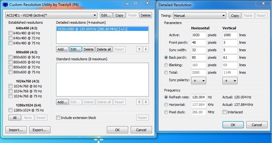

hello, i have an asusVG248 ( AMD Radeon HD 7700 Series - gigabyte H87-HD3 )
i'm using it for the simplest game in the world, just click when an halo appears ( here is the game ) but i've absolutely no amelioration ![]() for this kind of game , the lightboost should be helpful, no ? so i don't know if the lightboost works correctly... ( furthermore when i make the testufo i've that :[Image: http://img.imagesia.com/fichiers/eu/frequence_imagesia-com_eu84_small.PNG] ) installation of toasty was good , i've ticked that [Image: http://img.imagesia.com/fichiers/eu/asus_imagesia-com_eu83_small.PNG] when i turn the strobing, it becames so dark ( grey ) so i must put high brightness but i'vve tested 10% too and not better, hope someone will can help me because i'm bored to don't see amelioration at this game since the buy of this monitor compare to some others standard monitor ( 2eaches more little ! ) without any specific settings put, |

(01-02-2014 03:57 AM)thomasz1 Wrote: when i turn the strobing, it becames so dark ( grey ) so i must put high brightness but i'vve tested 10% too and not betterThat sounds like it's working, but LightBoost won't help much with low frame rate browser games. Your screen shot shows five VS247 monitors connected. Is that correct? The UFO test may not work properly if a 60 Hz monitor is connected, but LightBoost will function properly. |

(01-02-2014 02:47 AM)DanaG Wrote: Okay, this might be somewhat off-topic, but it may be possible to sniff what registry changes that Intel tool makes, and then incorporate them into StrobeLight.How did you initialize the monitor? Simply adding custom resolutions is not enough. LightBoost has to be unlocked first. |

(01-03-2014 06:09 AM)ToastyX Wrote:(01-02-2014 02:47 AM)DanaG Wrote: Okay, this might be somewhat off-topic, but it may be possible to sniff what registry changes that Intel tool makes, and then incorporate them into StrobeLight.How did you initialize the monitor? Simply adding custom resolutions is not enough. LightBoost has to be unlocked first. Good point -- I had already unlocked it using a Radeon HD5750, and well before that, an NVIDIA card in a laptop. I haven't unplugged my monitor in a while to check which of those can actually unlock LightBoost. |

(01-03-2014 06:07 AM)ToastyX Wrote:(01-02-2014 03:57 AM)thomasz1 Wrote: when i turn the strobing, it becames so dark ( grey ) so i must put high brightness but i'vve tested 10% too and not betterThat sounds like it's working, but LightBoost won't help much with low frame rate browser games. yes 5 vs247 and 1 VG248 ( and the changes are those of the vg248 of course )ok, snif ![]() even though, thank you for the answer
