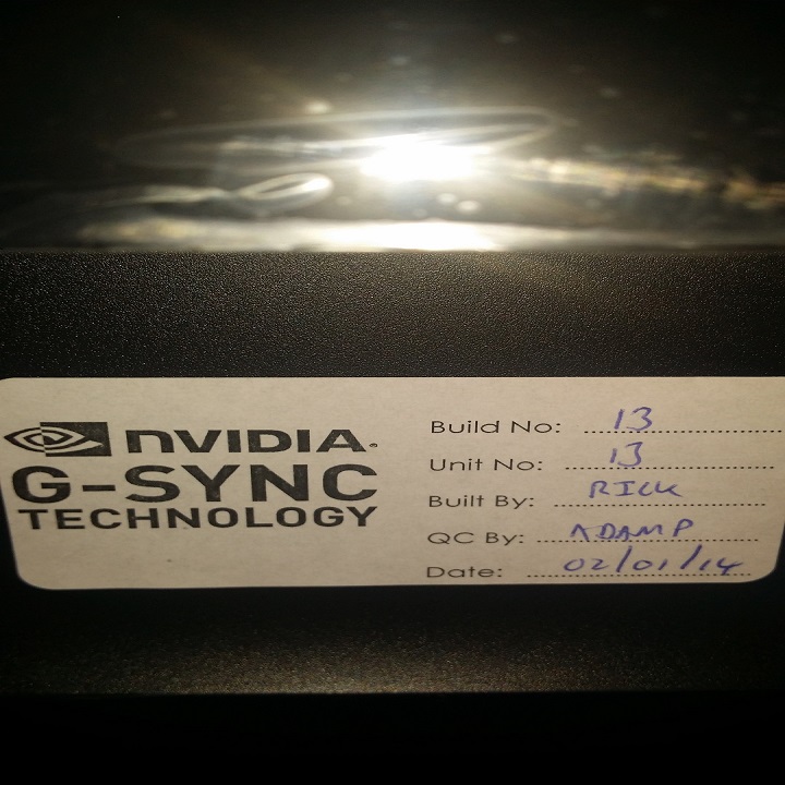

Hey toasty the asus VG248QE g-sync edition arrived 2 days ago Smile
Pretty happy very nice technology...
Iam a littlebit scared when it comes to the build number tho Big Grin
The major issue tho when i try to initialize stroblight it says no supported displays found or something like that
Is there any way u can make this work?
I mean just imagine it would be totally sick! Big Grin
thanks in advance Idea
