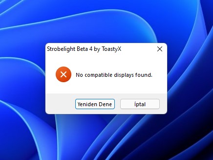

I had been using Strobelight with no issues for 2 years at Windows 10 and have been using for 3 months at Windows 11. But yesterday, after upgrading my Nvidia Driver to 511.23 version, Strobelight decided not to work with the error of "No compatible displays found." at startup. The strange thing is, I can see the installed refreshed rates and the monitor is working at 3D Mode in monitor's pop up menu. Frankly Strobelight is working as it should but the tray icon isn't there to use because of the error at startup. Is there anything I can do? Monitor: Asus VG248QE System: Windows 11 Debug: Code: [2022-01-16 19:40:52.542] LOAD(AMD): LoadLibrary("atiadlxx.dll") = ERROR 126 |

(01-16-2022 04:53 PM)Jinba ittai Wrote: I had been using Strobelight with no issues for 2 years at Windows 10 and have been using for 3 months at Windows 11. But yesterday, after upgrading my Nvidia Driver to 511.23 version, Strobelight decided not to work with the error of "No compatible displays found." at startup. The strange thing is, I can see the installed refreshed rates and the monitor is working at 3D Mode in monitor's pop up menu. Frankly Strobelight is working as it should but the tray icon isn't there to use because of the error at startup. Is there anything I can do?That error means it can't communicate with the monitor. Once 3D mode is unlocked in the monitor, Strobelight only acts as a resolution switcher. Strobing will continue to work as long as the monitor doesn't lose power. Something must have changed in the driver that broke DDC communication with the monitor. Use this to get a more detailed log: https://www.monitortests.com/strobelight-d2.zip You can rename that to strobelight-skip.exe to skip initialization, but if the monitor loses power, it won't be able to unlock 3D mode. |

I can second Jinba ittai's report that it appears Nvidia Drivers 511.23 broke something as I can no longer initialize the display. Same error as above: Code: [2022-01-31 01:42:11.805] LOAD(AMD): LoadLibrary("atiadlxx.dll") = ERROR 126As soon as I rolled back to 497.29 initialization succeeded again (after which I updated the drivers once more, since 3D mode remains active as long as the monitor isn't unplugged from power). I'm on Windows 10 and both drivers used are DCH. I hope you can look into this but even if you don't I still appreciate the work you've done; and it's not a major issue to install older drivers to re-init with when there's a power outage (or to connect the monitor to a UPS!). Best regards! Edit: I should also note that even when started with strobelight-skip.exe it cannot adjust the initialized monitor's brightness anymore. |

If NVIDIA broke something in their driver, I can't do anything about it. Are you using DVI or DisplayPort? I tested with DVI and it still works, but DisplayPort doesn't. You can still initialize the monitor with HDMI or HDMI-DVI if your video card doesn't have DVI. Don't install the refresh rates with HDMI. It will say no strobed refresh rates found afterwards, but don't worry about that. After it's done, you can switch back to DisplayPort and use strobelight-skip.exe. It won't be able to adjust the monitor brightness because it can't communicate with the monitor.

The monitor is indeed connected via DisplayPort to a 3080, so no Dual-Link DVI ports unfortunately.
I will test initializing the monitor via HDMI in the next few days and report back; it's certainly a much better workaround than rolling back drivers. Thanks for the help and swift response! EDIT: HDMI initialization tested and working fine. Cheers! |
