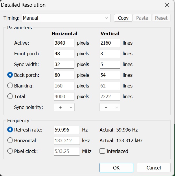

I am hopeing you could help me with understanding what i need to do to achive a resolution of 5760x4320 over two displayports @60hz so 2880x2160 over dp1+dp2 on the up3218k I did use the SRE to get 2880x2160 I also tryed the CRU to get 5760x4320 with no luck i understand that this has something to do with the extension blocks and this is where i am confused, what do i need to do in this extension block to achive 5760x4320 I am on Nvidia rtx 3070TI visual step by step examples would be helpful as i can copy your results. Thank you edit - If i only use one of the display port i can access the extention block information however this only works for one of the dispayports not both dp1 or dp2 and together. i again tryed adding 5760x4320 and 2880x2160 to the extention block edit and did not give me 5760X4320 what am i doing wrong are the lines or the mhz the problem here should i remove everything and only add what resolutions i want to achive to both dp1 and dp2 without nowing the details eg pixels lines mhz ect |

Ive attached some pics that might be helpful to you
a visual response outlineing what units i would have to put in to the lines if this was to work eg the tilt and if i would have to copy that tilt on both dp1 and 2 / active and nonactive - exstension blocks i will have a mess around see if i can set the right numbers i require but i really have no idea what i am doing and thank you for your response. |
