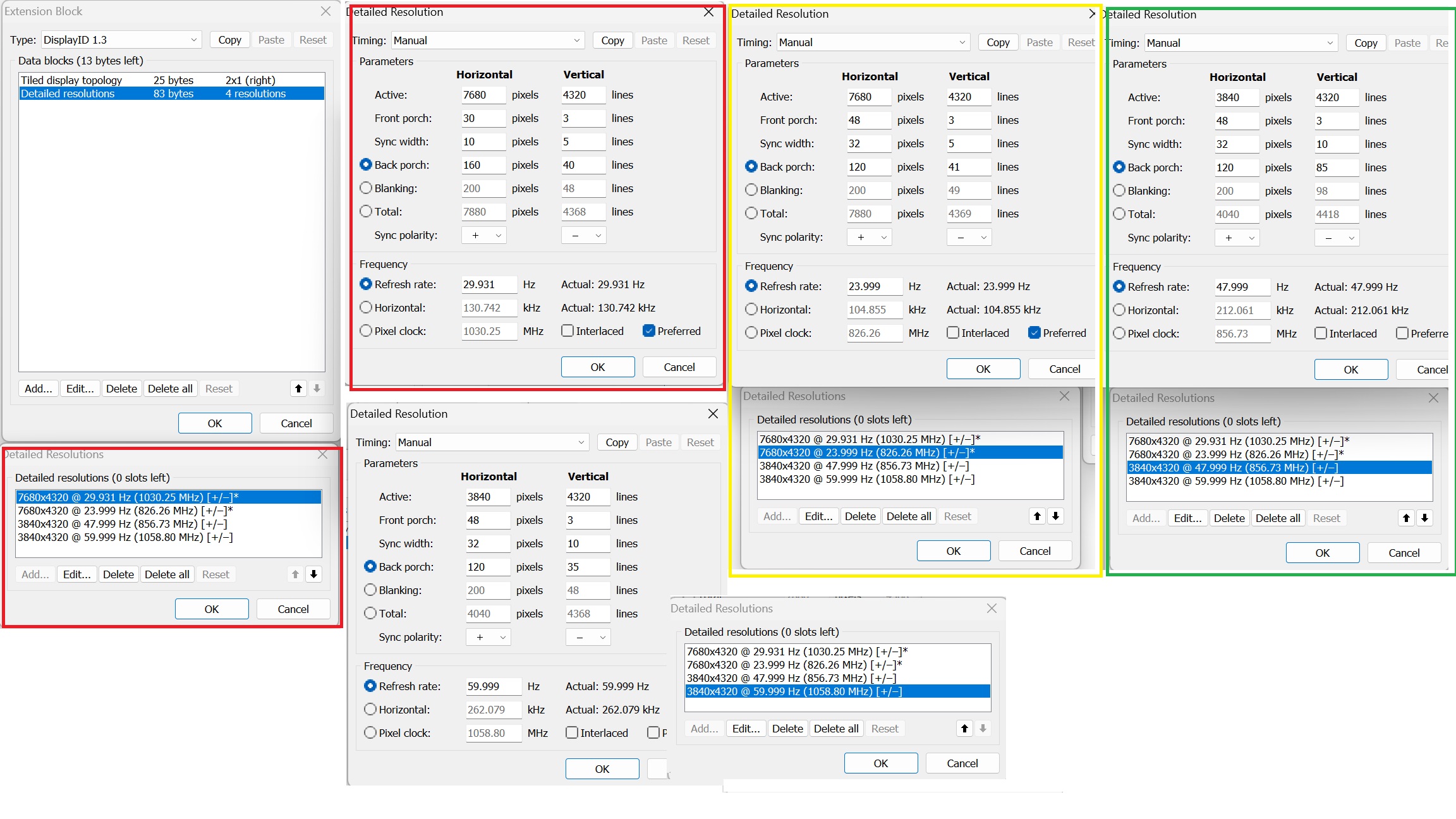

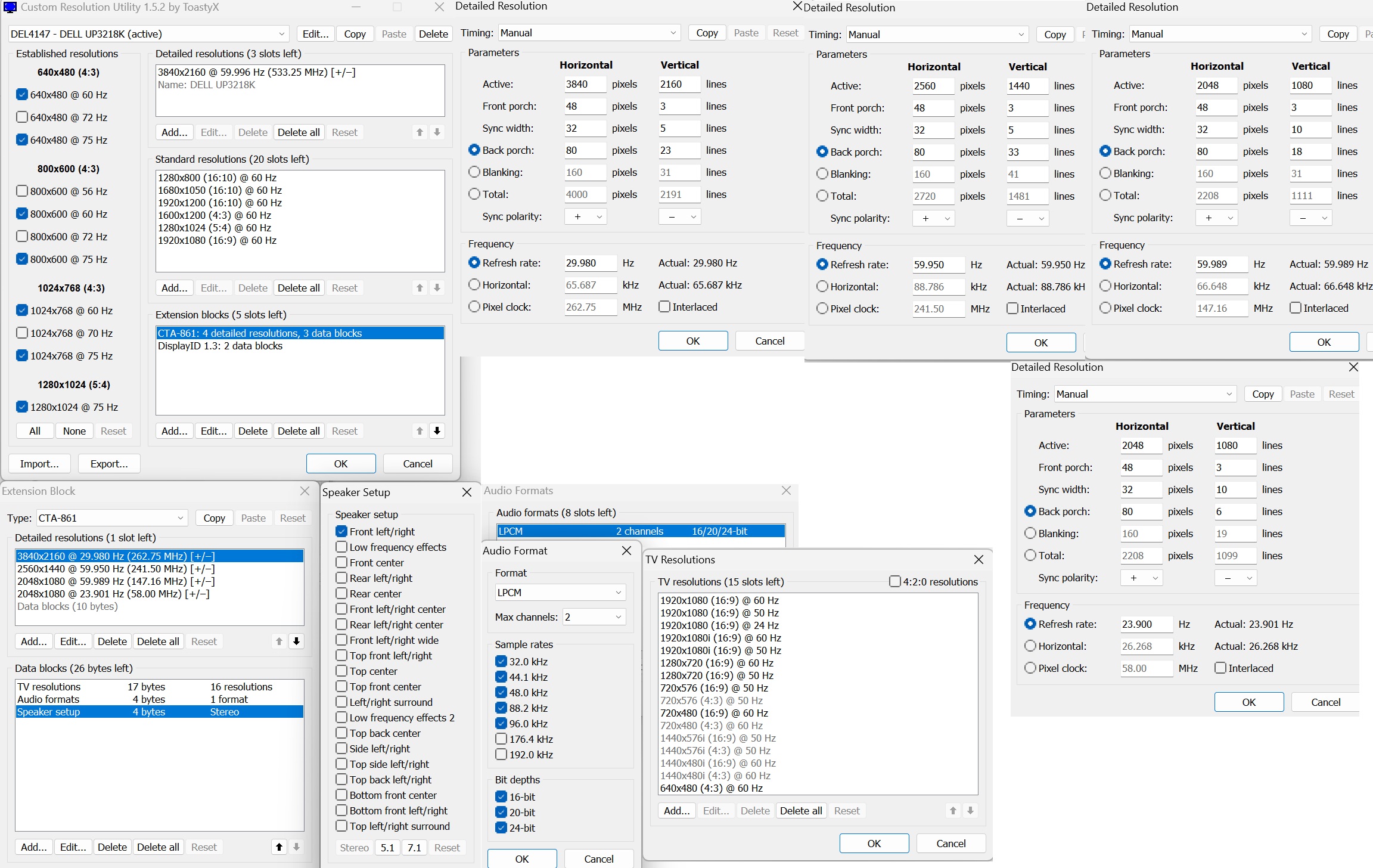

					Ive attached some pics that might be helpful to you a visual response outlineing what units i would have to put in to the lines if this was to work eg the tilt and if i would have to copy that tilt on both dp1 and 2 / active and nonactive - exstension blocks i will have a mess around see if i can set the right numbers i require but i really have no idea what i am doing and thank you for your response. | |||
