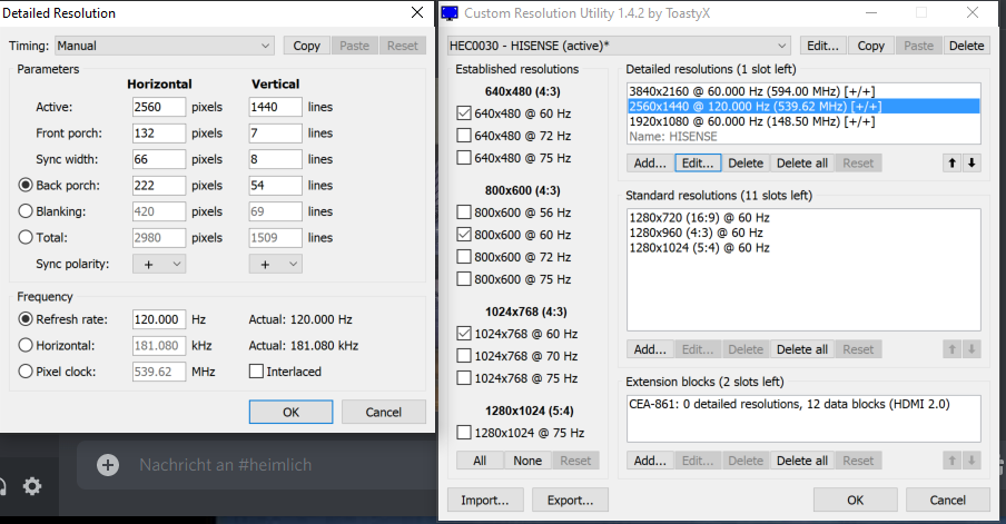

Can this tool break TV's?
I'm asking because I got a new Hisense U8B TV and when I was plugging it into my PC I couldn't find any settings for 120hz.
The resolution I was going for was 1440p @ 120hz through HDMI 2.0 . Should work, shouldn't it?
Well , at least I got a stable signal. I used the middle value between 1080p and 4k and changed 60hz for 120hz , and the Output was showing 120.00 hz too. Can you just change the Hz without editing the other values?
So I was playing some THPS1+2 in HDR (RGB mode) , some RDR2 and couple other games and it ran smooth and I couldn't be happier.
But now a few days ago the backlight of the TV seems to have broken and I'm not sure if its because of this tool, wrong values or god knows.
It got so bad that the TV isn't usable anymore as the backlight doesnt start.
Even when the HDMI isn't plugged in anymore.
Thing is, if I point a flashlight to the tv I can still see picture, it's just not lit.
If I had to guess this tool shouldn't make a difference to the LED array backlightning should it? As I mentioned, WHEN the picture was there I couldn't see any issues at all. But the device seems to have an issue turning on the LED Array.
Luckily I can return the device so thats what I'll do.
Have I been just shit out of luck or could I have missused this tool which caused the LED Array to fail?
I'll attach the screens with the values (1440p is the custom one) maybe you can see something.
Because if I get the same TV Model again from the seller, I don't want to run into the same mistake again. Would it help to put it down a notch, to 100hz ?
Man I'm stressed because of this x)
thanks for reading
regards
10-21-2020, 01:20 AM
Post: #5176
(10-20-2020 07:48 PM)therazorah Wrote:  Can this tool break TV's?
The timing parameters aren't important and wouldn't break a TV. It sounds like the TV had a bad backlight component. The only way using a higher refresh rate would break the backlight is if the TV has a design flaw and was overdriving the backlight because of the refresh rate, but the panel supports 120 Hz, so that shouldn't happen.

(10-21-2020 01:20 AM)ToastyX Wrote:  The timing parameters aren't important and wouldn't break a TV. It sounds like the TV had a bad backlight component. The only way using a higher refresh rate would break the backlight is if the TV has a design flaw and was overdriving the backlight because of the refresh rate, but the panel supports 120 Hz, so that shouldn't happen.
Thank you for your quick feedback. I was thinking in that direction too.
Now I'm just not sure if I should pay an additional 400€ for a Q70T or stick to this TV and turn it down to 100hz maybe. Or it won't make a difference 'cause the device I got was faulty in the first place.
When I get the replacement device in 1 month (either the same or another model) I'll let you know if it happened again or not. lets hope not^^
regards

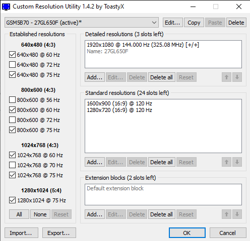

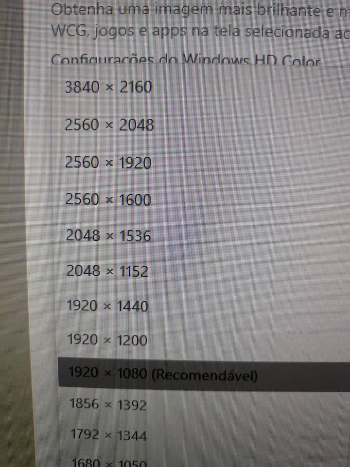

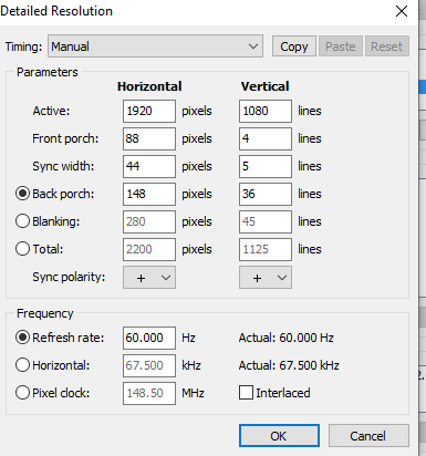

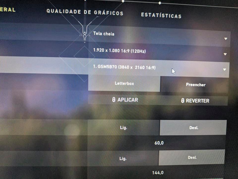

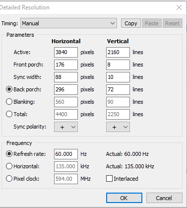

10-22-2020, 12:21 AM (Last edited: 10-22-2020, 12:58 AM by LLopesx)
Post: #5180

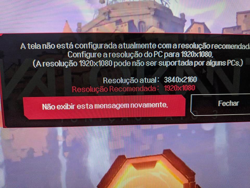

Hi, Im with a weird problem with my monitor, i bought it recently, it's a 1080p 144hz monitor and i use it with my laptop i5 7200u and a 930mx from nvidia,
I never added more resolutions to my monitor, and when i launched a game my monitor got into 3840x2160, then i gone to resolutions on windows and there was an option to go to this weird resolution, but 1080p was selected as the recommended resolution.
A few research and i got into your program expecting to just delete this resolutions but they weren't there, here is a few screen captures of my problem:
User(s) browsing this thread: 214 Guest(s)
