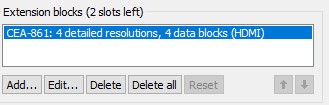

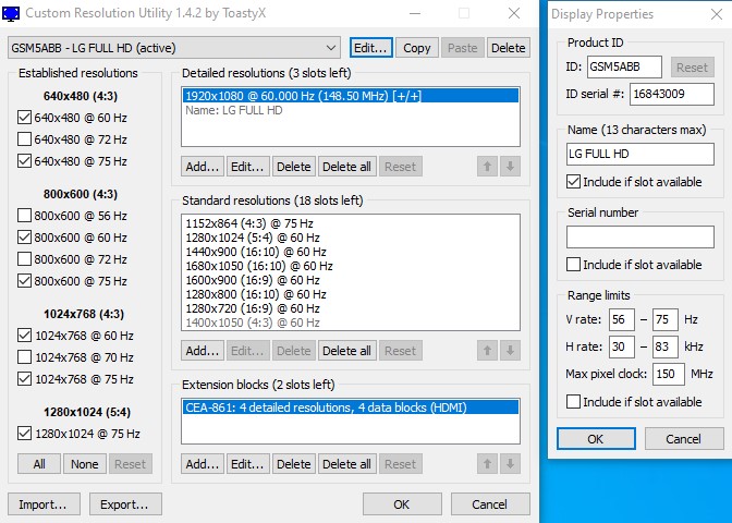

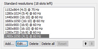

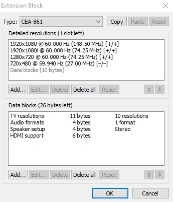

I have overclock monitor my monitor is->https://www.lg.com/in/monitors/lg-22M38H# with custom resolution utility and i don't know how to back to default my monitor support only 60hz and no 75hz i don't have display port only hdmi. So my problem is how to go my monitor back to 60hz? Here is my screenshots...
At the last choice extension blocks (2slots left)
CEA-861: 4 detailed resolution, 4 data blocks (HDMI) then i click edit The type is CEA-861 Detailed resolutions
1920x1080 @ 60.000 Hz (148.500 Mhz) [+/+]
1920x1080i @ 60.000 HZ (74.25 Mhz) [+/+]
1280x720 @ 60.00 hz (74.25 Mhz) [+/+]
720x480 @ 59.940 hz (27.00 Mhz) [-/-]
Data blocks
TV resolutions
Audio Formats
Speaker Setup
HDMI Support
So i have open cru now at the top left need to untick 75hz and to left as is it 60hz? Established Resolution.
Detailed Resolution need to do something else or change?
Standard Resolutions: Need To delete 75hz , 16:10 and left as is it 16:9? Or i can add standard resolution 1920x1080? or other resolutions
Extensions Block: Need to delete these resolutions?->1920x1080i @ 60.000 HZ (74.25 Mhz) [+/+]
And the last step: Data Blocks
I want to delete tv resolutions audio formats and maybe speaker setup.
I tryed to make as is it but no luck i got a black screen to my pc. My monitor is 75hz and i want to go at 60 hz. Which settings must to do?

(10-14-2020 02:11 PM)Christosk88 Wrote:  I have overclock monitor my monitor is->https://www.lg.com/in/monitors/lg-22M38H# with custom resolution utility and i don't know how to back to default my monitor support only 60hz and no 75hz i don't have display port only hdmi. So my problem is how to go my monitor back to 60hz? Here is my screenshots...
Run reset-all.exe and reboot to reset the monitor back to default. I don't see anything wrong with the screen shots. They don't show an override in place, and 1920x1080 is at 60 Hz like it should be. Some monitors define 75 Hz at lower resolutions by default, so that's not a problem.

10-15-2020, 03:03 PM
Post: #5169
(10-15-2020 12:12 PM)Christosk88 Wrote:  Ok say that if i click reset.all exe then my monitor will turn on or i will have black screen?
Running reset-all.exe simply resets software settings. It will not affect the monitor itself.
10-15-2020, 04:07 PM
Post: #5170
Actually i made some change in settings i click add and then i select Automatic - old standard then i put in standradr resolutions 800x600, 1024x768 then extension block i deleetd everything and i kept only hdmi after cllicked restart.exe and then restart my computer after restart computer i went to nvidia control panel and i saw only pc 1920x1080 (native) and not 1080p, 1080i, 720p cause i deleted in another profile and then in nvidia control panel see only pc 1920x1080 (native).
So, about the reset all.exe i will try it some point.
