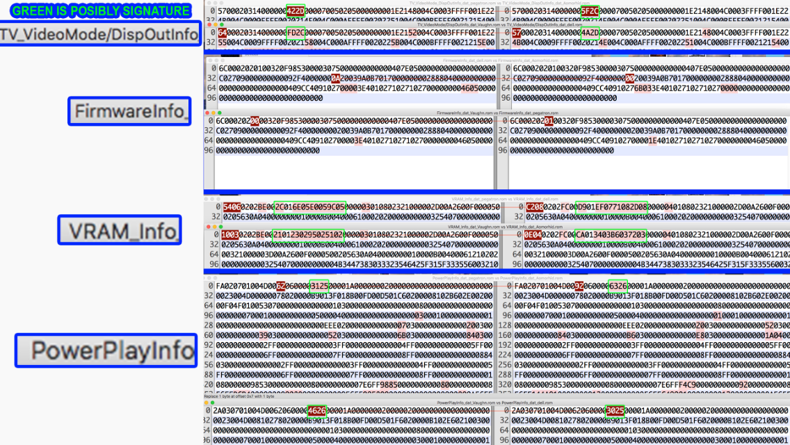

Hi! I’m working on app for rebuilding modules in vbios. And early method working file. But I stuck with vbios signature verification. I compare all modules of four vbioses and find out that PowerPlayInfo includes some different two bytes 3125, 3025, 4626, 6326... etc... so possibly they are signatures.
If you know the location of signature in vbios and driver, it could be very useful, thanks!
