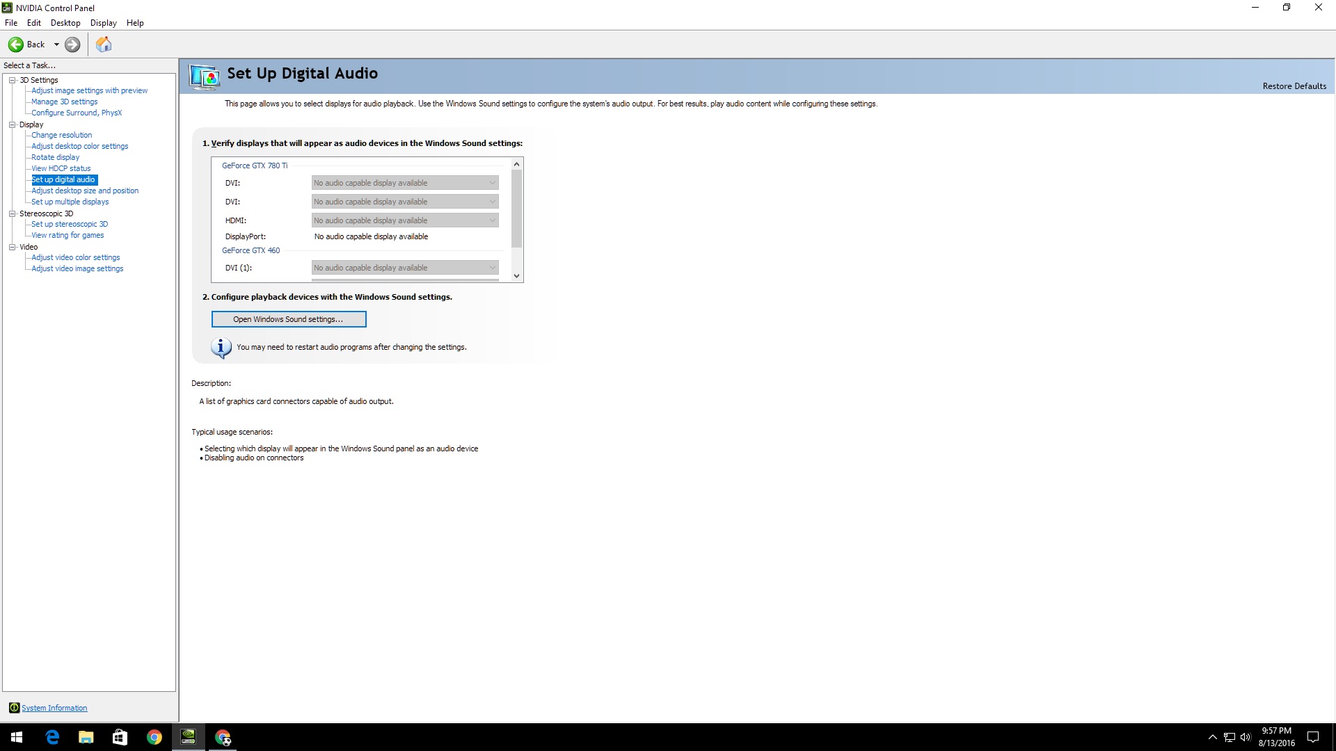

Lost sound on Seiki se39uy04 after following steps
Title says it all. I have an EVGA gtx 780 ti and I use my Seiki se39uy04 as my monitor (connected using hdmi 1.4). I love having it at 120 hz at 1080p for gaming and other misc. things but it would come with the annoyance of the screen going black for a couple of seconds and then reappearing displaying the 1920x1080 resolution along with the 120hz refresh rate (this would happen about every 10-20 minutes). I followed this tutorial and this one (http://blog.ysutopia.net/?p=362) to create my own resolution and pixel timer (with even values) to get a stable 120 hz at 1080p. My screen no longer blanks! Unfortunately as I solved one problem there is another...Problem is that now I have no sound coming out my TV! In my Nvidia control panel, my connector for resolution is only recognized as DVI - PC display. How do I get it so I can keep my custom 1080p 120hz resolution but get my connector to be recognized as hdmi so I can receive sound again? Thanks
