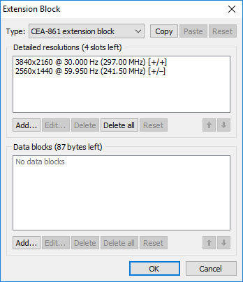

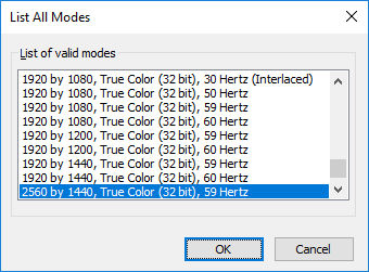

Hi, ToastyX! Thanks for all your hard work with this tool and CRU!
I recently replaced an 11-year old Dell 3007WFP 2560x1600 display with a BenQ BL3201PH 3840x2160. My PC is running Windows 10 Pro with a Radeon HD4800 of some sort. I had two Dells hooked up to it, each via dual-link DVI @ 2560x1600. I unplugged one of them and plugged in the BenQ, without shutting down Windows first. The new display was recognized, and I was able to select the 3840x2160 resolution in Display Settings. Tried out Photoshop and a few other things, and I was satisfied things were working correctly.

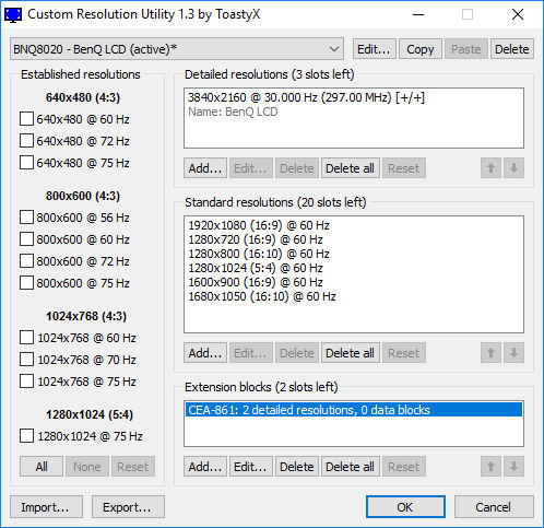

I reboot the machine just to make sure everything is happy, but now Windows will not let me select anything higher than 2560x1440. I run atikmdag, and initially it patches everything except "low-resolution limit". I run CRU 1.3 anyway, and sees that it already knows about 3840x2160 @ 30 Hz. Reboot, still no change. Run atikmdag again just to be sure, add the 3840x2160 entry into the extension block with CRU, run atikmdag again, notice that "low-resolution limit" has now been patched.... reboot again. Still no go. Windows does not seem to want to go above 2560x1440.
Checked the monitor tab in the display driver, and it only shows 59 Hz and 60 Hz, even with "hide modes" unchecked. Is this the root of the issue, that the driver will not do a 30 Hz refresh rate? It is clearly able to do so, since it was happy with that resolution before I rebooted the PC for the first time. Any thoughts on this?

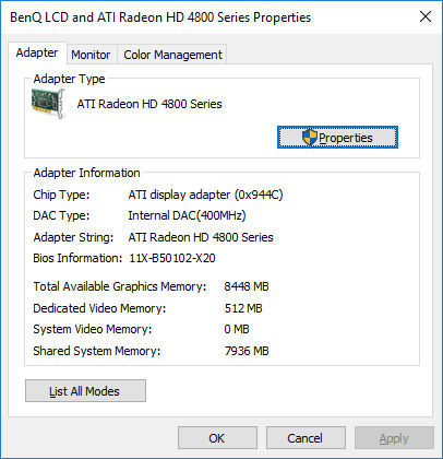

Downloaded the latest monitor driver from BenQ's site, attempted to install it, but Windows claims what it has is already the latest. I was thinking this was the problem because the monitor shows up just as "BenQ LCD" in Device Manager, rather than with a more detailed model number. Rebooted again, but still nothing.
Poked around a bit more on BenQ's site, downloaded their "Display Pilot" utility (manages monitor settings from Windows, etc.). While that was installing, I did a "scan for hardware changes" in Device Manager... displays blinked off and then on, BenQ comes back on but with _massive_ windows and icons, like it was running at 1024x768 on a 32" display. Looked closer, and discovered Windows was now running it at 3840x2160 but with 300% desktop scaling.
Checked the display adapter drivers, and it now shows 30 Hz as the only supported refresh rate, and 3840x2160 now appears in the list of supported resolutions. I don't think the Display Pilot software had anything to do with it, but it was forcing a hardware rescan (which I thought was done on boot) that did it.

None of this makes any sense. You shouldn't need the patch for 3840x2160 @ 30 Hz with dual-link DVI, and the patch is meant for 5000-series and newer cards anyway. I don't see how the low-resolution limit would not be patched the first time unless you used an older version of the patcher first, but you don't need the low-resolution limit anyway. You shouldn't need to add 3840x2160 @ 30 Hz with CRU because it's already there. Adding it again in the extension block should not make a difference. I don't see how forcing a hardware rescan would change anything unless there's a driver bug, but then you'd have to do that every time you reboot. Does 3840x2160 @ 30 Hz still work after rebooting?
