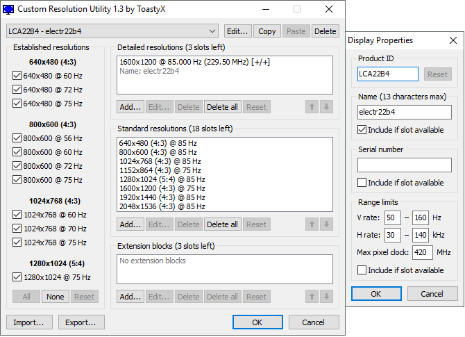

Anyway, I've run into a strange problem where Radeon GPU's on Windows PC's are running into artificial resolution limits in the driver, and they're ignoring overrides above this limit in CRU, and enforcing the same limit in AMD custom resolution tool. Basically, it seems to be looking at the max resolution or pixel clock on the EDID, and limiting the custom resolutions to near that maximum. Resolutions from CRU just won't show up, they're ignored and not selectable
Like when I hook up a Dell P992 (max resolution on EDID is 1600x1200@85hz, max horizontal scan 107kHz) I can't pick resolutions much higher than 2048x1536. But when I use my larger LaCie monitor, where 2048x1536@85hz is the max in the EDID, I can create resolutions with horizontal width around 2700 pixels, like 2736x2054@60hz.
These limits are not present on the actual GPU's VGA output. So for example, on both my Dell and LaCie monitor, I can create a 2880x1620 resolution, and it will display as long as it is within the monitor's range. This resolution, at any usable refresh rate, isn't possible running through the Sunix.
So it's clearly some sort of limitation the driver enforces on displayport when it reads the EDID, and it can't be overwritten. I should mention this is with Radeon+Windows+displayport specificially, another user tested the adapter in Ubuntu and didn't hit any driver-enforced roadblocks.

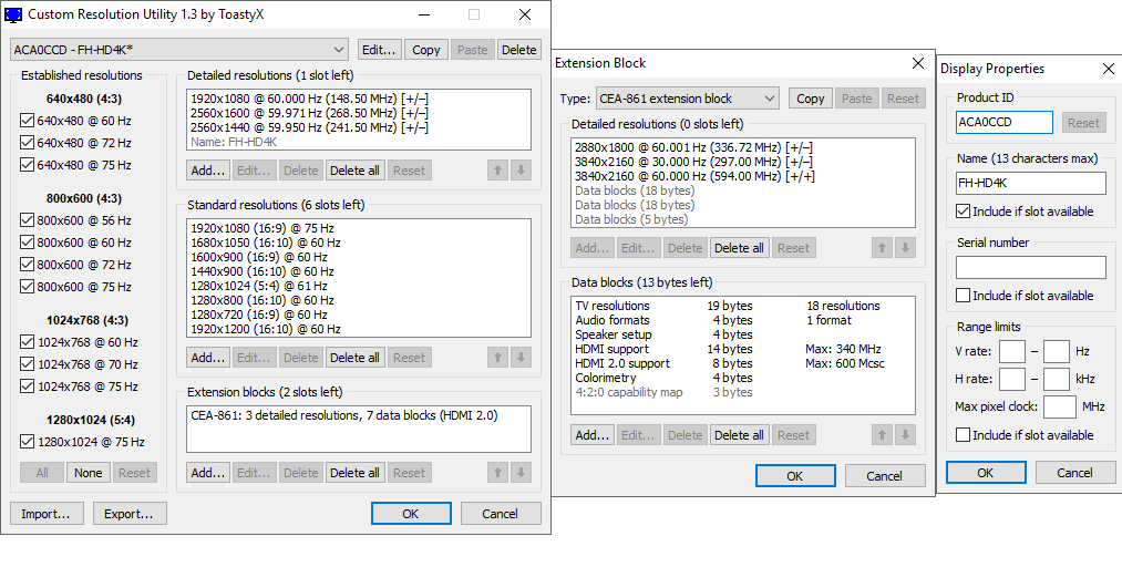

So what I did is I bought a spoof HMDI 2.0 plug with a 4k60 EDID, and ran it through an Extron switch where the DDC signals were pulled from the HDMI plug, but the RGBHV signals still made it to my actual monitor. My GPU read the spoof's EDID, but for some reason was limited to 2560x1600@60hz, much lower than some of the resolutions/refresh when I hooked up my LaCie to the Sunix.
So I was wondering if you could take a look at the two attached pictures of the EDID's. One is the LaCie, the other the dummy plug, and see if maybe you can tell why the 4k dummy plug isn't unlocking much higher resolutions options than the LaCie, considering the dummy plug has 4k60 in its EDID. Both of these are the EDID's read from the DDC lines, unaltered by me.
My best guess at the moment is that the 4k resolutions are all contained in the extension block, and thus are looked over by Radeon's drivers.
