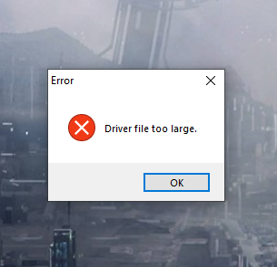

I am getting a "Driver file to large" error when attempting to patch the latest AMD driver 18.12.3. Is there a workaround for this problem with the latest driver?

(01-05-2019 04:57 PM)Hunted Wrote:  I am getting a "Driver file to large" error when attempting to patch the latest AMD driver 18.12.3. Is there a workaround for this problem with the latest driver?
You shouldn't be getting that message if you're using the current version of the patcher.

Hi , I put ver 1.4.6 under atiflash 2.84 Folder , I still get same Message.

(01-06-2019 10:11 AM)Xuper Wrote:  Hi , I put ver 1.4.6 under atiflash 2.84 Folder , I still get same Message.
Where did you get the latest driver from?
