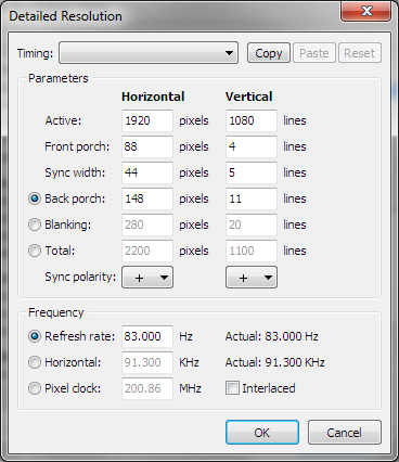

The only other thing I can think of is maybe you were using different timing parameters before. Some monitors have gaps in the refresh rates that they will display, but the driver should still list them. 83 Hz reminds me of the NEC EA231WMi, which only worked at 83 Hz with these specific timing parameters:
[Image: detailed.png]

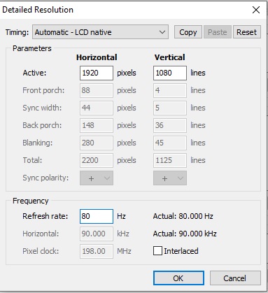

EDIT: Yup, I'm right. I just added 80Hz resolution on CVT reduced timings and pixel clock manually reduced to 164MHz. Anything works as long as it's below 165MHz pixel clock.

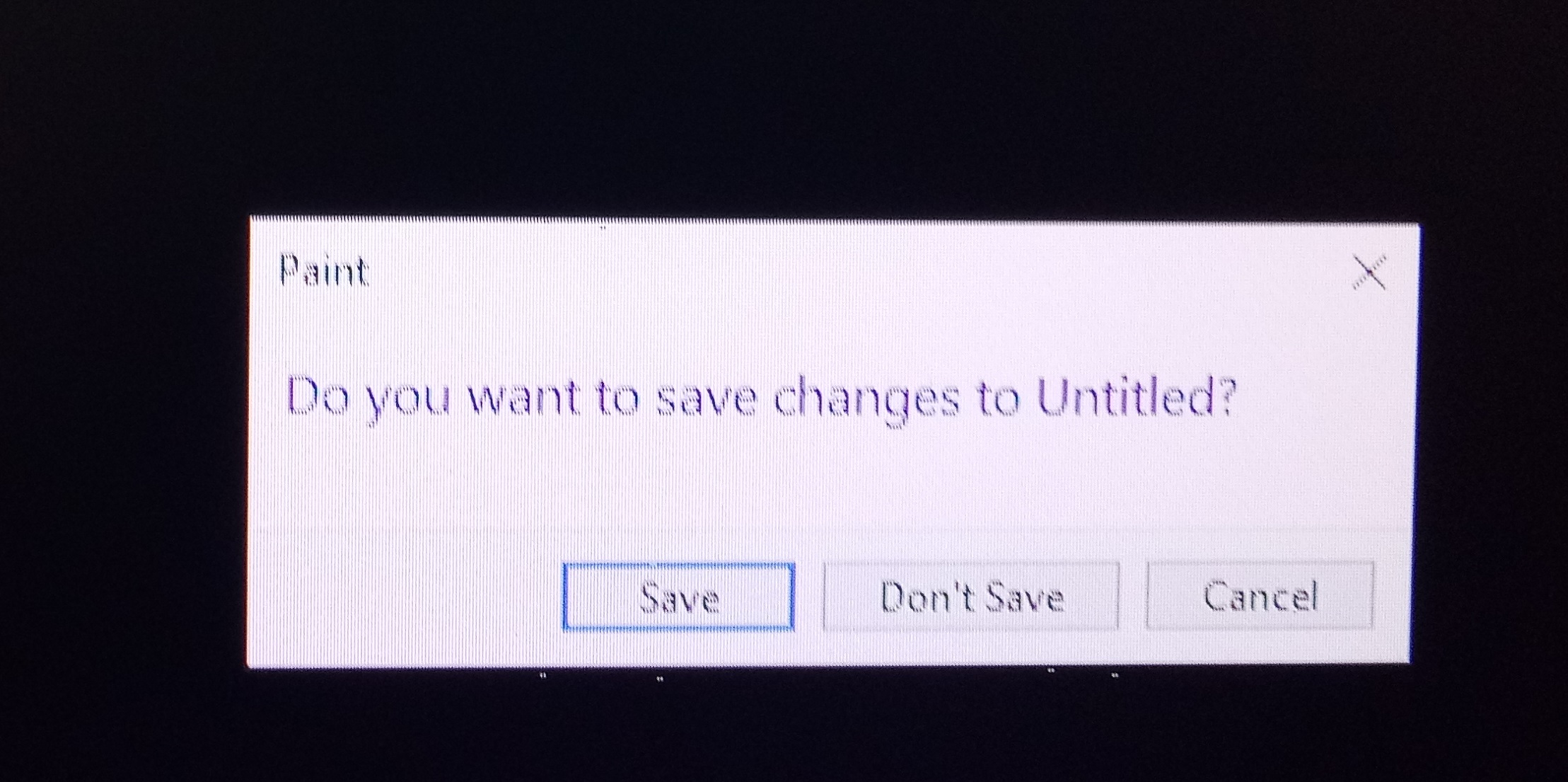

What does the random noise look like? At first, I thought you were talking about this: https://imgur.com/a/njclU, which is an HDCP issue with AMD's driver when the horizontal blanking is too low, but now I realize you might be talking about something else. Does the noise completely obscure the screen like that, or are you still able to see the screen but with some noise?

Manual: Did you try the 83 Hz timing parameters I posted? It's basically "LCD native" but with the vertical back porch set to 11. Try that at 80 Hz. Does it get listed? What does the monitor show?

Concerning the noise - it's just some pixels going white and blinking, as in the screenshot shows. Depending on how wrong timings are, they appear in different quantity on whole screen or contrasting edges. They're like a badly tuned TV.

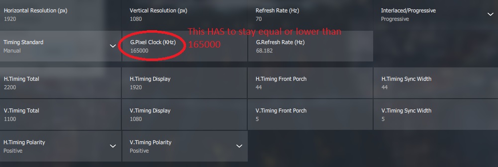

(05-13-2019 08:28 PM)SirHawk Wrote:  In example, I currently run 70Hz with timings set as in the screenshot from post #4011 but I had to lower pixel clock to 165MHz to be listed (and working without any random noise).
Those timing parameters at 165 MHz would be 68 Hz, not 70 Hz.
