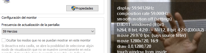

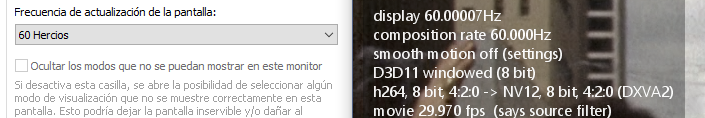

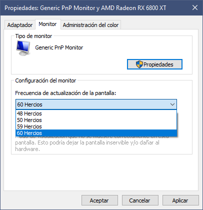

(01-18-2021 06:39 PM)RaulDJ Wrote:  Apparently you can't have both 60 and 59,94 Hz custom resolutions with modern Adrenalin drivers using CRU (?), it only shows the 60 Hz one.
I had absolutely no problems doing this on a GTX 1060 before but now with a 6800XT the only way I can make Windows to show both "60" (60 Hz) and "59" (59,94 Hz) refreshes is to use the Adrenalin driver to make at least that custom 59,94 resolution, and those only work when GPU scaling is disabled Huh.
That's never been possible. Windows only supports one of each refresh rate, and 59.94 Hz rounds to 60 Hz. "59 Hz" is an alias for 60 Hz, not a separate refresh rate.

(01-18-2021 06:59 PM)ToastyX Wrote:  That's never been possible. Windows only supports one of each refresh rate, and 59.94 Hz rounds to 60 Hz. "59 Hz" is an alias for 60 Hz, not a separate refresh rate.
Of course it is, that's just how I've been using your software for the past four and a half years: 59,94 Hz was shown as "59" and 60 Hz was shown as "60".
It still is like that right now, in fact, but I had to use the Adrenalin software.

(01-18-2021 07:44 PM)RaulDJ Wrote:  Of course it is, that's just how I've been using your software for the past four and a half years: 59,94 Hz was shown as "59" and 60 Hz was shown as "60".
No, that's not how it works. If you add 59.94 Hz with CRU, it gets listed as 60 Hz. If 60 Hz also exists, then the first resolution takes precedence. Then 59 Hz gets added as an alias of 60 Hz, perhaps with the pixel clock adjusted to be 59.94 Hz, but all the other parameters are the same.
Adrenalin custom resolutions are different because you can specify both the listed refresh rate and the actual refresh rate, and they don't have to match.

(01-18-2021 09:24 PM)ToastyX Wrote:  Adrenalin custom resolutions are different because you can specify both the listed refresh rate and the actual refresh rate, and they don't have to match.
I guess that's the way it is with these cards, but I still find it strange that adding 59,94 Hz to the CRU list on the 1060 makes Windows show both a 60 and a 59 options but not on AMD, which still only shows the 60 one. Thanks for the explanations though.
