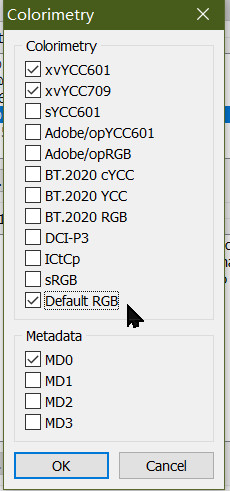

thanks ,I had learn how set the color format in the GPU's control panel,but is there a way to define the default color format via edid?

(11-05-2022 03:19 AM)simon52min Wrote:  thanks ,I had learn how set the color format in the GPU's control panel,but is there a way to define the default color format via edid?
That's not in the EDID. RGB is always supported. The only thing you can do is remove the YCbCr color formats by editing the HDMI data block. Colorimetry has nothing to do with this.
