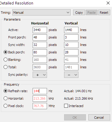

Hey there, so I'm having an issue setting a custom refresh rate with my native resolution. I have a 3440x1440 144Hz monitor that I wish to cap at 143Hz. It's an obscure issue but the TLDR is that my monitor occasionally skips every other frame down to 72hz at 144hz when the input is changed but does not have the same behavior at 145hz or 143hz. The issue is I can't set 10-bit color in the Nvidia control panel with a non-native refresh rate. Obviously, CRU fixes this issue but nonetheless, it will not accept any refresh rate above 122hz. I've attached a screenshot showing the issue with setting it to 144hz at 3440x1440 which is the monitor's native resolution and refresh rate. If anyone has any ideas it would be greatly appreciated. Thanks!

(12-30-2020 05:19 AM)Skok Wrote:  Hey there, so I'm having an issue setting a custom refresh rate with my native resolution. I have a 3440x1440 144Hz monitor that I wish to cap at 143Hz. It's an obscure issue but the TLDR is that my monitor occasionally skips every other frame down to 72hz at 144hz when the input is changed but does not have the same behavior at 145hz or 143hz. The issue is I can't set 10-bit color in the Nvidia control panel with a non-native refresh rate. Obviously, CRU fixes this issue but nonetheless, it will not accept any refresh rate above 122hz. I've attached a screenshot showing the issue with setting it to 144hz at 3440x1440 which is the monitor's native resolution and refresh rate. If anyone has any ideas it would be greatly appreciated. Thanks!
Please read the first post.
