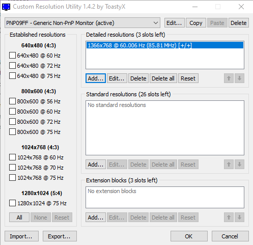

01-07-2021, 04:13 PM (Last edited: 01-07-2021, 04:15 PM by choichoi10)
Post: #5551
(01-07-2021 03:20 PM)ToastyX Wrote:
(01-07-2021 02:49 PM)choichoi10 Wrote:  the firsts screenshot is wrong mybad, my monitor has always been detected as generic non pnp even with other vga cables and the resolutions are there already when i used Cru, what should i put in the extension block? really need help because idk how this works
You don't need an extension block. You only need one detailed resolution for 1366x768 @ 60 Hz and nothing else.
"Non-PnP" means the graphics driver couldn't read the EDID, so there shouldn't be any resolutions in CRU by default.
I tried this and gave me bsod "system thread exception not handled" Sad
01-07-2021, 06:45 PM
Post: #5552
(01-07-2021 04:13 PM)choichoi10 Wrote:  I tried this and gave me bsod "system thread exception not handled" Sad
That's a driver bug then. What driver version do you have installed? Try installing the latest NVIDIA driver with the clean install option.
The real problem is the EDID on the monitor is probably corrupted, so it's not being detected correctly. I don't know what you can do if the driver won't accept an EDID override. Maybe a cheap active HDMI-VGA adapter would work around the problem.
Im using the latest nvidia 461.09 drivers. this problem only started after I switched to nvidia 750ti. Last time while im using amd 6570 the native resolution is being detected just fine.
01-08-2021, 02:36 AM
Post: #5559
(01-07-2021 11:02 PM)choichoi10 Wrote:  Im using the latest nvidia 461.09 drivers. this problem only started after I switched to nvidia 750ti. Last time while im using amd 6570 the native resolution is being detected just fine.
Try unplugging the monitor's power for a minute just in case it's a firmware glitch.
If that doesn't help, try importing this file with CRU (and enable "Import complete EDID"):
.dat  s19d300.dat (Size: 553 bytes / Downloads: 1802)
