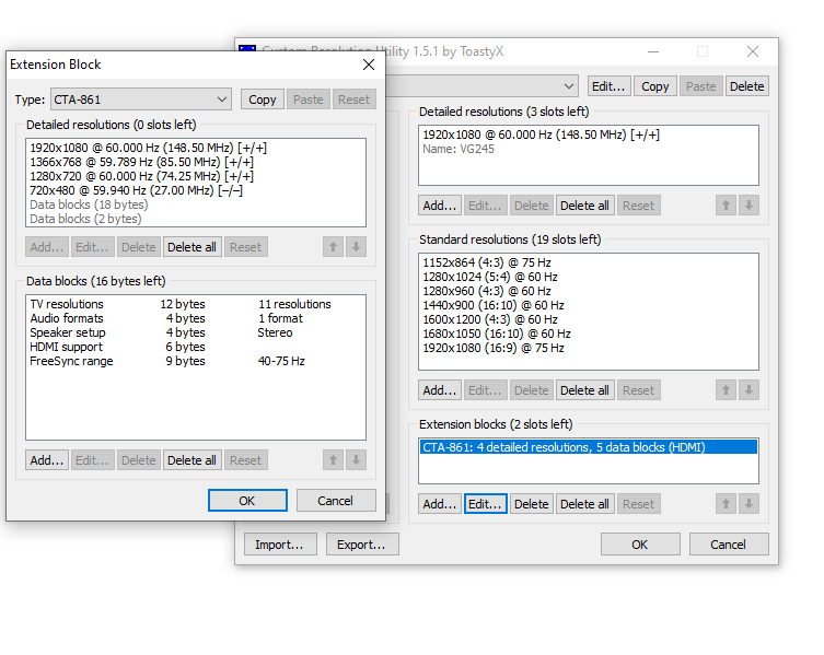

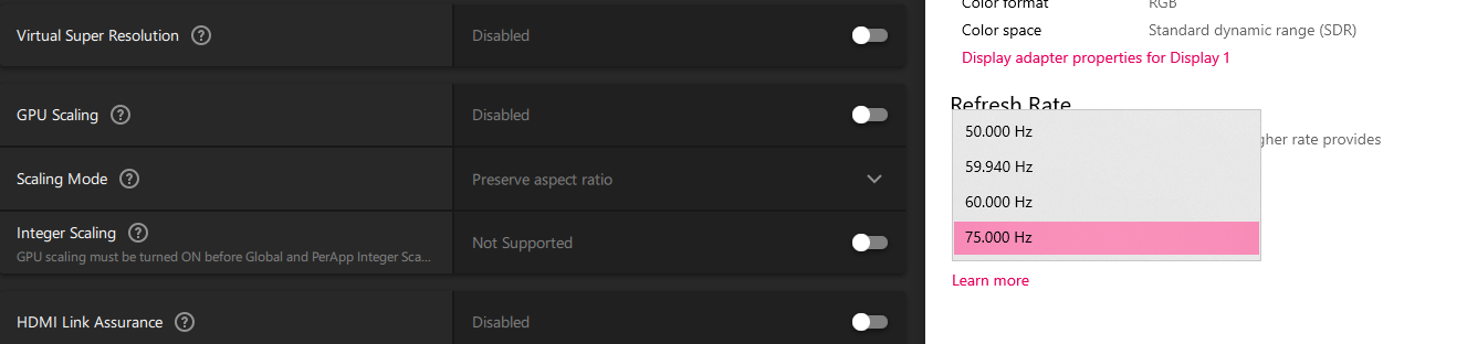

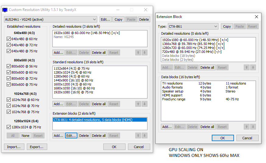

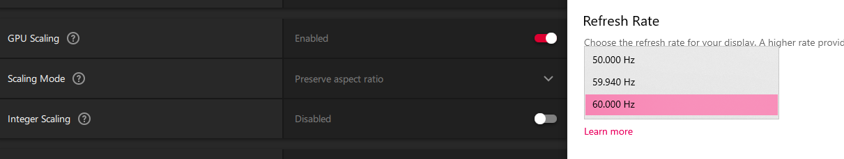

06-25-2021, 09:48 PM (Last edited: 06-25-2021, 09:55 PM by nihaomiao)
Post: #5920
(06-23-2021 01:22 AM)ToastyX Wrote:
(06-20-2021 07:13 PM)nihaomiao Wrote:  Using CRU disabled freesync in the AMD driver saying "it's not supported".
All I did was:
Enable GPU scaling (needed it for something)
Notice windows removes the 75hz setting then which is the max my monitor supports.
Used CRU to simply add it back.
AMD driver disabled freesync.
Asus VG245
5700 XT
I don't see how you used CRU to add 75 Hz back when the monitor already defines 75 Hz, and enabling GPU scaling shouldn't disable refresh rates, so that seems like a driver bug. Try including the range limits using the "Edit..." button at the top. CRU doesn't normally include that, and it shouldn't be needed for HDMI FreeSync, but maybe that's another driver bug.
This is what CRU shows me (and I could sworn in the top block it used to say 75hz too before the recent windows/amd updates). Adding it in attachments.
Also images showing how the 75hz disappears once GPU scaling is selected.
What CRU shows me after the GPU scaling change seems identical to before, under the extension blocks edit too (since I'm on HDMI).
