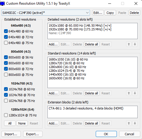

Hi there, new to CRU but I managed to overclock my monitor up to 70hz, i have a problem though, i play CSGO and sometimes I like to use 1280x960 stretched but it's 60hz and on CRU at established resolutions I only see 1024x768 (60, 70, 75hz) and 1280x1024 (only 75hz) but i don't see 1280x960, do i have to add it manually on detailed resolutions and overclock it to 70hz or is it not available at all?
Also as i mentioned 1280x1024 is 75hz can i make it be 70hz instead?
Sorry if this is a weird question but i don't know a lot about this kind of stuff and decided to ask before i take any further steps.

(08-25-2021 02:18 PM)Adenis Wrote:  i play CSGO and sometimes I like to use 1280x960 stretched but it's 60hz and on CRU at established resolutions I only see 1024x768 (60, 70, 75hz) and 1280x1024 (only 75hz) but i don't see 1280x960, do i have to add it manually on detailed resolutions and overclock it to 70hz or is it not available at all?
1280x960 is available if you add it under "standard resolutions" and you can accordingly input a custom refresh rate with something above 60Hz.
But I can do you one better - why not make a custom resolution of 1440x1080 instead? That will give you better visual clarity since your monitor itself is 1080p so there won't be any vertical scaling occurring, only horizontal (though since 1440x1080 isn't listed as a preset "standard resolution", you'll need to select "Other resolution" and then input the according resolution values - or alternatively just straight-up make a "detailed resolution").
...and if your GPU drivers are set up accordingly, you might even be able to use a custom resolution of 1920x1440 which would look even clearer as there's no longer any upscaling occurring with the horizontal axis being a perfect match for your screen while the vertical will effectively have 1.3x SSAA.

Established resolutions are basic modes predefined by the EDID standard. You can add any resolution you want as a detailed resolution. Common lower resolutions like 1280x960 are also possible as standard resolutions.
