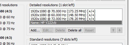

(11-17-2021 01:59 AM)windy401 Wrote:  I tried using this on my new monitor (HP V222vb) and it seemed to work fine going from 60->70hz. However now I notice that windows now calls the monitor "wired display" instead of "HP V222vb" even after restarting and putting everything back to original settings. I'm concerned I may have screwed something up, has anyone seen this happen before, should I be worried?
Windows should show whatever name is shown in CRU, but you have to make sure the name is showing in the detailed resolutions list. If you add resolutions and it pushes the name off the list, then Windows won't show a name. Nothing you do in CRU should be permanent since it doesn't modify the monitor.
Hmmm. Looks like the name in there is fine.
"Nothing you do in CRU should be permanent since it doesn't modify the monitor."
Figured as much, but the reassurance is nice, lol.

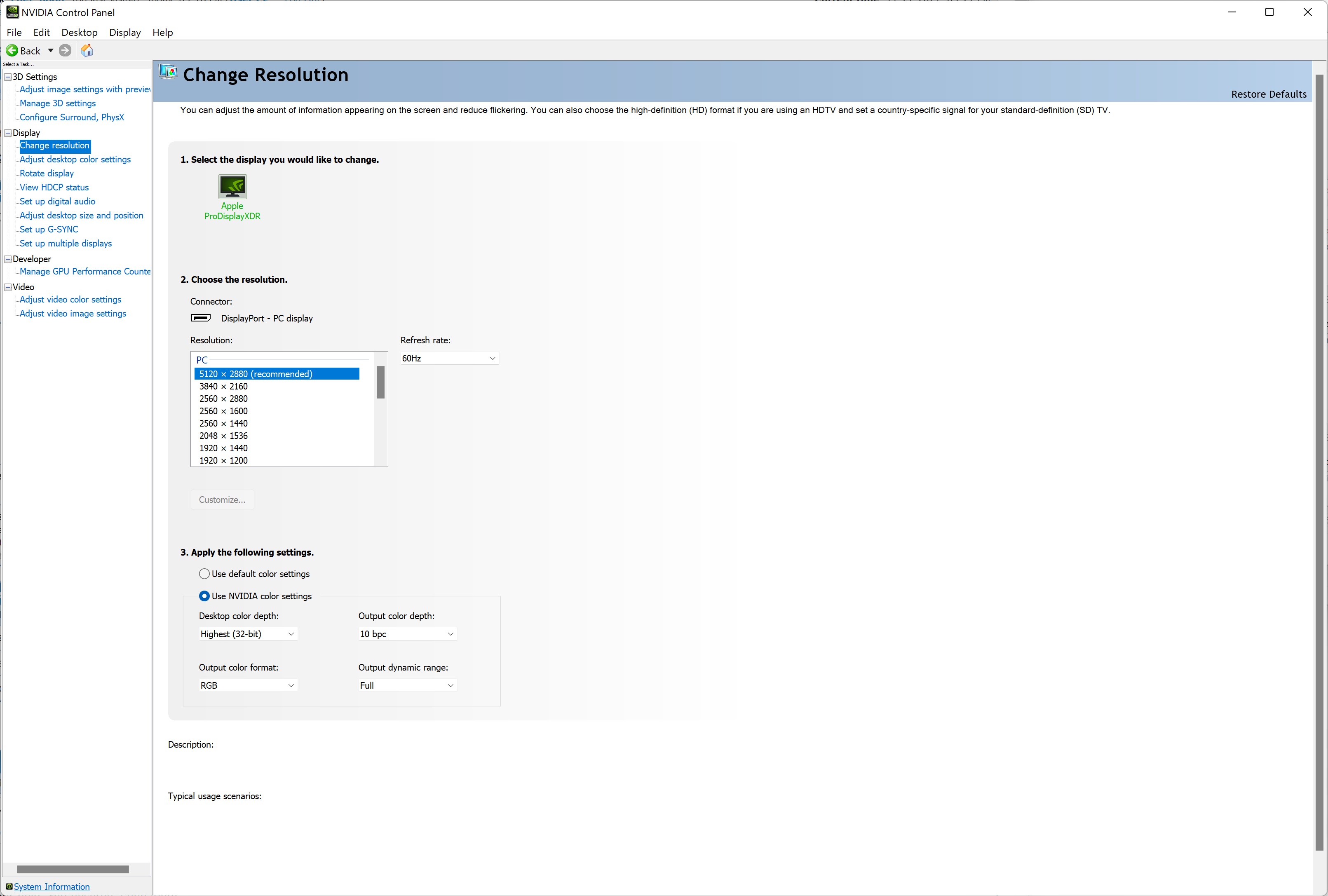

I've been trying to get my Apple Pro Display XDR to show its full 6k resolution over Thunderbolt 3 on my Windows desktop, and I'm looking for some help. My motherboard (ASRock x570 ITX TB3) has a TitanRidge TB3 controller with DP1.4, so there's enough bandwidth to support 6k...but, as reported by others ( https://forums.macrumors.com/threads/app...t-29114824 ), Windows doesn't seem to expose a 6k resolution when using TB3. On the other hand, I'm able to support 5k with 10 bits (or even 12, despite the monitor only being 10 bit), which is more bandwidth than 6k8bit -- so I'm convinced this is an EDID problem.
I've tried the following:
1) Downloaded Bootcamp drivers, which don't really seem to install "drivers"; instead Apple installs a discrete Bootcamp helper app that lets you interact with the display to change brightness and color profile (but not resolution)
2) I've exported the EDID data of the display when in Mac (attached), and I'm looking into writing a custom driver using this data and Microsoft's documentation ( https://docs.microsoft.com/en-us/windows...itor-edids ). I'm not familiar with writing INF files on Windows, so I'm pretty sure I'll botch something.
3) I've tried using NVIDIA Control Panel to set a custom resolution, but that option is greyed out (screenshot attached).
4) I've tried switching from NVIDIA GeForce Drivers to NVIDIA Studio Drivers (both are available for my RTX 3090) to see if I have the option to load a custom EDID override, but, sadly (and inexplicably) that drop-down is not available (screenshot attached).

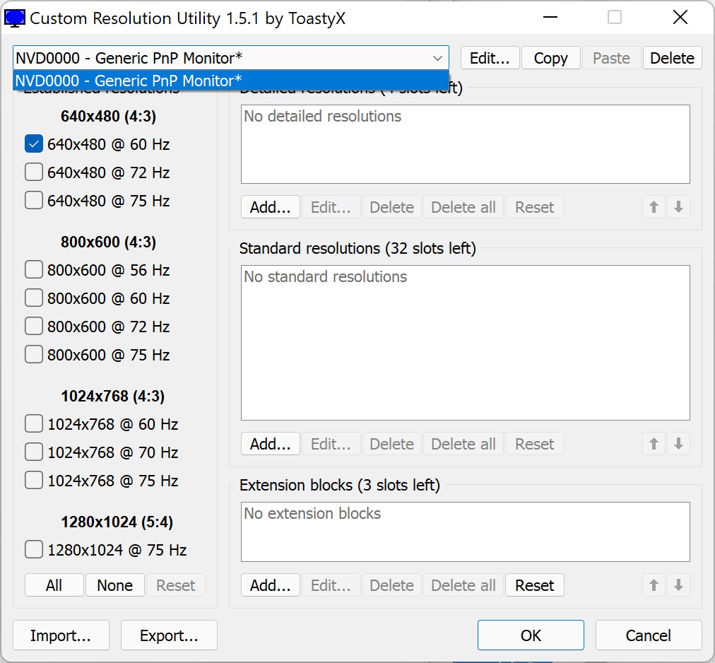

5) I've tried using CRU to set a custom resolution, but I don't think the device is showing up properly. The only display CRU finds is "NVD0000 - Generic PnP Monitor*" which has a max resolution of 640x480 (screenshot attached). This sounds like some sort of virtual display, and judging from the Registry I'm pretty sure it is (Computer\HKEY_LOCAL_MACHINE\SYSTEM\CurrentControlSet\Enum\DISPLAY is attached) since I'm pretty sure I want APPAE22 which (I think) is the ProXDR judging from the EDID.
Any help would greatly appreciated! Any suggestions?

(11-22-2021 05:33 AM)chef_pooh Wrote:  I've been trying to get my Apple Pro Display XDR to show its full 6k resolution over Thunderbolt 3 on my Windows desktop, and I'm looking for some help. My motherboard (ASRock x570 ITX TB3) has a TitanRidge TB3 controller with DP1.4, so there's enough bandwidth to support 6k...but, as reported by others ( https://forums.macrumors.com/threads/app...t-29114824 ), Windows doesn't seem to expose a 6k resolution when using TB3. On the other hand, I'm able to support 5k with 10 bits (or even 12, despite the monitor only being 10 bit), which is more bandwidth than 6k8bit -- so I'm convinced this is an EDID problem.
Can you describe how everything is connected? From what I've read, you need two DisplayPort cables from the NVIDIA GPU to the Titan Ridge controller, but I only see one DisplayPort input on the motherboard. The 6K resolutions don't fit within the max pixel clock for DisplayPort 1.3/1.4 HBR3 (1080 MHz pixel clock at 8 bpc), so either it requires two streams or display stream compression (DSC). Maybe the Titan Ridge controller is preventing DSC from working. Why not connect the monitor directly to the video card using the Moshi USB-C to DisplayPort cable?
I don't think anything is wrong with the EDID. The reason CRU doesn't list the monitor is because the reported EDID in the registry is supposed to be the first 128 bytes only, but apparently that changed with Windows 11, and your monitor is reporting 5 extension blocks, while older drivers only supported up to 3, so CRU saw too much data and failed to process the monitor. I will fix that in the next version. For now, try this: https://www.monitortests.com/CRU-EXT.zip
