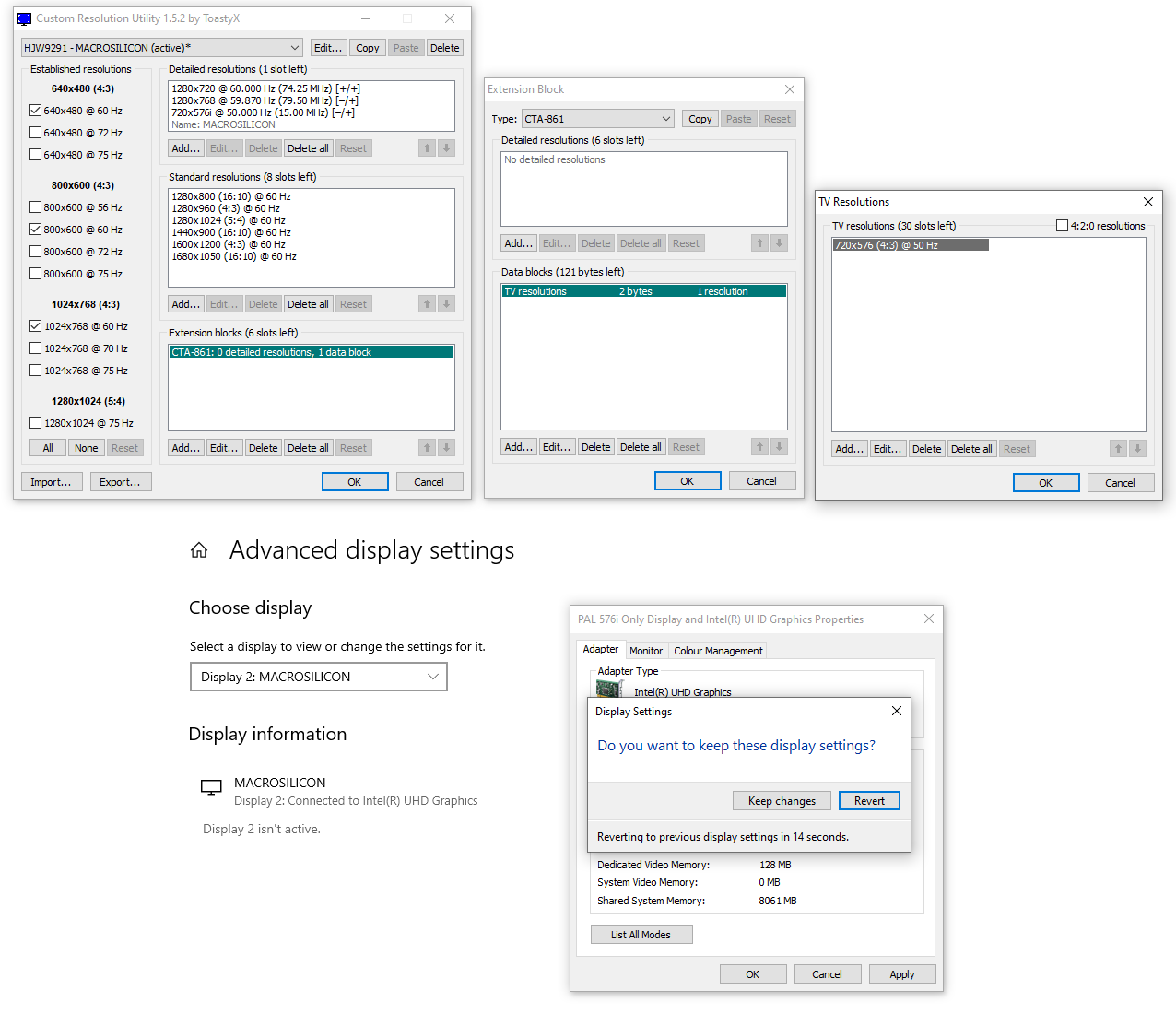

hello! this isn't a problem with CRU per se but i have an issue that CRU seems to have caused. for the past week or so I've been putting 576i at 50hz over hdmi into an analogue converter to get PAL video for a TV. I used CRU to create a custom cta-861 block and windows was totally fine with it, it worked perfectly until i used CRU to create a different unrelated resolution and now the hdmi converter will not be recognised by windows as an active monitor at all if i try to put an interlaced resolution into it. I can put literally any progressive resolution into it (although it appears scrambled on screen obviously) but the instant i choose an interlaced resolution, windows's display settings say the monitor "isn't active", blanks the screen and will not allow me to change any settings, so i have to reinstall the device.

(06-30-2025 03:42 PM)kalamaike Wrote:  hello! this isn't a problem with CRU per se but i have an issue that CRU seems to have caused. for the past week or so I've been putting 576i at 50hz over hdmi into an analogue converter to get PAL video for a TV. I used CRU to create a custom cta-861 block and windows was totally fine with it, it worked perfectly until i used CRU to create a different unrelated resolution and now the hdmi converter will not be recognised by windows as an active monitor at all if i try to put an interlaced resolution into it. I can put literally any progressive resolution into it (although it appears scrambled on screen obviously) but the instant i choose an interlaced resolution, windows's display settings say the monitor "isn't active", blanks the screen and will not allow me to change any settings, so i have to reinstall the device.
576i is supposed to be 1440x576i. HDMI doesn't officially support pixel clocks less than 25 MHz. The driver shouldn't have let you choose 720x576i if the hardware can't do it, so that's a bug in Intel's driver.

oh! that works perfectly! thanks very much im glad i know that now. i assume me updating the intel driver must have patched a bug out hence me being completely unable to recreate it. much appreciated!
(06-30-2025 06:19 PM)kalamaike Wrote:  oh! that works perfectly! thanks very much im glad i know that now. i assume me updating the intel driver must have patched a bug out hence me being completely unable to recreate it. much appreciated!
okay, sorry, it appears i spoke too soon, obviously with double the resolution everything is now squashed by 50% - is there a way i can keep the aspect ratio at 4:3 while maintaining the resolution?

(06-30-2025 06:19 PM)kalamaike Wrote:  okay, sorry, it appears i spoke too soon, obviously with double the resolution everything is now squashed by 50% - is there a way i can keep the aspect ratio at 4:3 while maintaining the resolution?
Windows doesn't have any concept of aspect ratios and only supports square pixels, so the only way I can think of is to add 720x576p @ 50 Hz and set the GPU scaling option to stretched in Intel's control panel and hope that it will scale 720x576p to 1440x576i. 1440x576i @ 50 Hz would need to be the first detailed resolution to make it native.
Really 576i is supposed to be double-clocked so each pixel is repeated twice, but the EDID standard doesn't have a way to specify double clocking. You can also try adding 576i as a TV resolution by choosing "Other resolution" and entering code 21. I didn't include that because AMD and NVIDIA ignore it, but maybe Intel will listen to it and double clock it.
