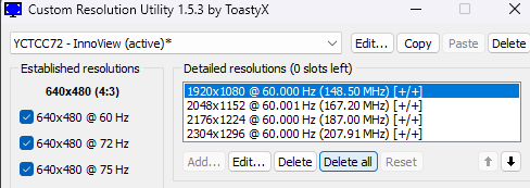

(06-21-2025 12:03 AM)ToastyX Wrote:(06-20-2025 06:17 PM)KE3JU Wrote: It works great on monitor 1, but has no affect on monitor 2. They're identical monitors, both on the same video card (Intel UHD Graphics 630).You need to be more specific. What monitors are these? How is each monitor connected? HDMI? DisplayPort? Is this a desktop or laptop? What changes are you making? Did you make the same changes on both monitors? Desktop Machine two of these ( https://www.amazon.com/dp/B09K3FWMPL/?tag=mtests-20#ad ) connected via HDMI on both. The changes are in attached image. The computer is: Manufacturer=LENOVO ManufacturerSeries=ThinkCentre M920x Model=10S10000US |

(06-25-2025 12:20 PM)KE3JU Wrote: Desktop Machine two of these ( https://www.amazon.com/dp/B09K3FWMPL/?tag=mtests-20#ad ) connected via HDMI on both.I only see one HDMI port on the M920x. How are you using HDMI for both? |

(06-26-2025 09:12 PM)ToastyX Wrote:(06-25-2025 12:20 PM)KE3JU Wrote: Desktop Machine two of these ( https://www.amazon.com/dp/B09K3FWMPL/?tag=mtests-20#ad ) connected via HDMI on both.I only see one HDMI port on the M920x. How are you using HDMI for both? It has two. These machines were very customizable when ordering. I ordered it with 2 HDMI ports. I can post a photo if I need to prove it. (06-27-2025 01:03 PM)KE3JU Wrote:(06-26-2025 09:12 PM)ToastyX Wrote:(06-25-2025 12:20 PM)KE3JU Wrote: Desktop Machine two of these ( https://www.amazon.com/dp/B09K3FWMPL/?tag=mtests-20#ad ) connected via HDMI on both.I only see one HDMI port on the M920x. How are you using HDMI for both? Is there something in Device Manager I can provide to help with this? |

(06-27-2025 01:03 PM)KE3JU Wrote: It has two. These machines were very customizable when ordering. I ordered it with 2 HDMI ports. I can post a photo if I need to prove it.Is the problem isolated to a specific port or a certain monitor? Can you check each monitor individually on each port? (06-27-2025 01:03 PM)KE3JU Wrote: Is there something in Device Manager I can provide to help with this?The EDIDs would be more helpful. Export a file for each monitor and post them here. |

(06-27-2025 05:28 PM)ToastyX Wrote:(06-27-2025 01:03 PM)KE3JU Wrote: It has two. These machines were very customizable when ordering. I ordered it with 2 HDMI ports. I can post a photo if I need to prove it.Is the problem isolated to a specific port or a certain monitor? Can you check each monitor individually on each port? Both Monitors work in the primary port, just not the second port. I'll work on getting the EDIDs. |
