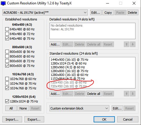

CRU Custom Resolution not available?
Hello! I have a question/issue...
I am trying to apply a custom resolution to windows 10x64bit with a Radeon HD4850 graphics card, however the resolution is not showing in windows after restarting the driver and/or computer, additionally any resolution I apply is showing as light gray in CRU... what does light gray mean?
-Running as Administrator/by administrator

(05-16-2017 07:07 PM)Sithered Wrote:  Hello! I have a question/issue...
(09-07-2012 09:06 PM)ToastyX Wrote:
  • AMD/ATI only supports the resolutions in the drop-down list. Other resolutions will be ignored by the driver. These will be listed in gray.
You should add them as detailed resolutions. If you're using DVI, the driver will also ignore resolutions less than 25 MHz pixel clock, so you'll have to use the "CRT standard" timing option for 720x450 @ 60 Hz. Also, Windows will not list resolutions lower than 640x480, but they are available for programs to use.
