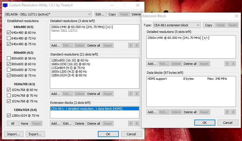

Thanks again for this great utility. I've got my settings shown in the attachment, and wanted to know if I need to set up the resolution in both the main window and the block window as I've done here. I occasionally still have the problem of waking up my laptop and finding that the resolution on my large external monitor has reverted to the bad default, and I have to run restart64.exe.
I could delete the resolution from the main window, but I don't want to mess up anything.
Thanks.

(10-04-2017 01:57 PM)Chrismartin76 Wrote:  Thanks again for this great utility. I've got my settings shown in the attachment, and wanted to know if I need to set up the resolution in both the main window and the block window as I've done here. I occasionally still have the problem of waking up my laptop and finding that the resolution on my large external monitor has reverted to the bad default, and I have to run restart64.exe.
You need the resolution in the main window. You don't need it in the extension block. Losing the override after waking up from sleep would be a driver bug that Intel would have to fix.

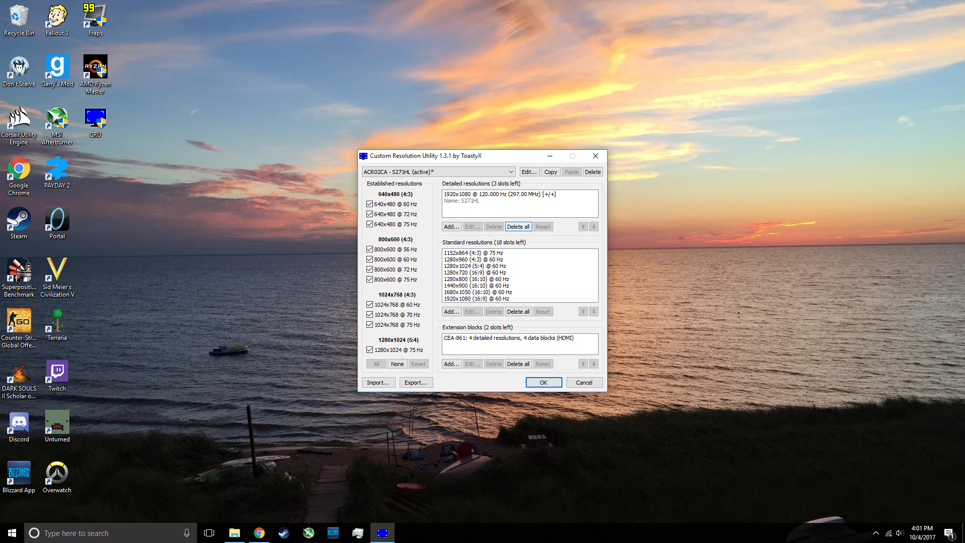

I am trying to overclock my Acer S271HL 60hz 1080p monitor and when I overclock in the app, it works and it works fine after I restart the driver with restart.exe, but when I go to windows settings->monitor to change the refresh rate, it only has the default numbers, no 120hz that I have added in detailed resolutions.

First, a 60 Hz monitor is not going to get 120 Hz, but 75 Hz might be possible. Second, what GPU is this?
