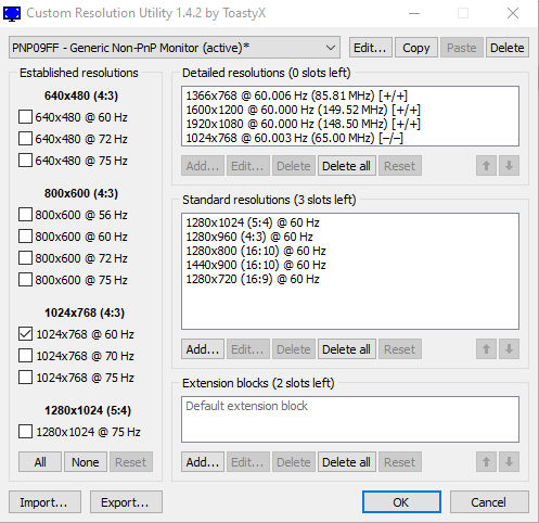

750ti using vga cable to my vga monitor (Samsung s19d300)
this is what i did and 1366x768 is still not detected as native resolution:
01-07-2021, 02:14 PM
Post: #5547
(01-07-2021 05:30 AM)choichoi10 Wrote:  750ti using vga cable to my vga monitor (Samsung s19d300)
You can't have a default extension block with NVIDIA, and something is wrong with the monitor or cable because it shouldn't be detected as a non-PnP monitor. Where did you get these resolutions from? The other screen shot you showed me is not the correct EDID for a Samsung monitor.

01-07-2021, 02:49 PM (Last edited: 01-07-2021, 02:57 PM by choichoi10)
Post: #5549
the firsts screenshot is wrong mybad, my monitor has always been detected as generic non pnp even with other vga cables and the resolutions are there already when i used Cru, what should i put in the extension block? really need help because idk how this works

01-07-2021, 03:20 PM
Post: #5550
(01-07-2021 02:49 PM)choichoi10 Wrote:  the firsts screenshot is wrong mybad, my monitor has always been detected as generic non pnp even with other vga cables and the resolutions are there already when i used Cru, what should i put in the extension block? really need help because idk how this works
You don't need an extension block. You only need one detailed resolution for 1366x768 @ 60 Hz and nothing else.
"Non-PnP" means the graphics driver couldn't read the EDID, so there shouldn't be any resolutions in CRU by default.
