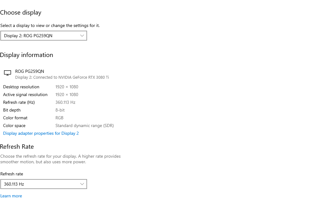

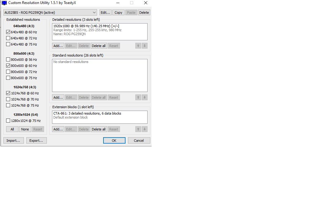

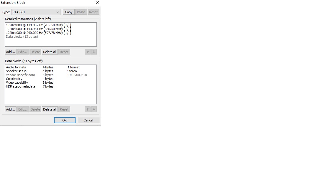

Hello I was messing with CRU and after resetting all settings to default every resolution has option for 144hz except 1920x1080 which highest refresh rate is 120 [Image: VfQyB28.png] [Image: SR08LbV.png]

(08-28-2021 09:51 AM)senseijus Wrote:  Hello I was messing with CRU and after resetting all settings to default every resolution has option for 144hz except 1920x1080 which highest refresh rate is 120 [Image: VfQyB28.png] [Image: SR08LbV.png]
Is this after running reset-all.exe? Did you add 1920x1080 @ 144 Hz as a custom resolution using the NVIDIA control panel? If so, it would be listed separately under custom resolutions. If not, then there's a driver bug because the only reason 144 Hz exists for the lower resolutions is because it exists at the native resolution, so the driver is recognizing the resolution but not listing it properly. Does it appear in the Windows display settings?
