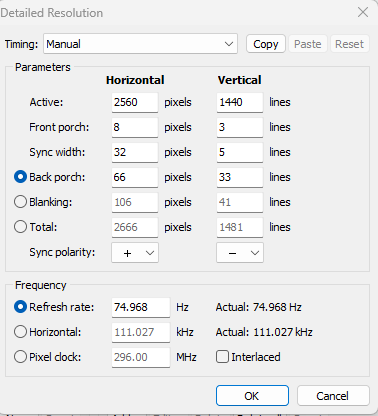

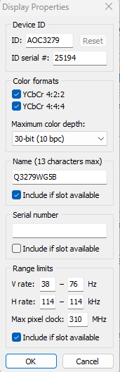

12-08-2022, 01:37 PM (Last edited: 12-08-2022, 02:46 PM by iakoboss7)
Post: #7089
Hello and thank you very much for this amazing tool and support!
Monitor: AOC Q3279VWFD8
GPU: Sapphire Nitro+ RX 480 8GD5 (UEFI) SKU number: 11260-07
Connection: DisplayPort cable that came with monitor, using 10bit color depth.
Windows 11 22H2 , Latest AMD driver (atm 22.11.2) [I have created the custom resolution in CRU and not in AMD driver settings, idk if its correct?]
CRU settings: Look in screenshots
Stock @75hz (which does not seem to follow the VESA standard)
My over/under-clocked @76hz, changed freesync also from 48-75 to 38-76
My target is to get the "correct/best" settings for my monitor to achieve "LFC" (which requires the maximum freesync range to be at least x2 of the minimum freesync range).
I have it already working except a weird "tear/stuttering" that happens at ~@38fps probably because it is just about double and not even 1hz more as I get blank screen above 76.1/76.2 Hz.
But I am not sure if the monitor timings are correct and maybe hurting something Sad

But now aside from this new problem where CRU is not changing the EDID, I know where the old problem is which is the EDID is wrong. I know I wanted NIS so I left it being turned on as it is current is, but create problems. I didn't want to clean reinstall nvidia drivers as that will set to default profile which NIS will be turned off. So I try to use CRU timing as "Native PC", it doesn't seem like anything different from "Automatic PC", but this time I also delete the 1 original detailed resolution there, even if it seems like the correct resolution and similar refresh rate and create the 2 detailed resolutions I wanted again.
but guess what, it worked. and I did not try to do anything else after that. because the EDID might get changed again and unable to change back. Having to use CRU twice is indeed puzzling. Until I face the problems again, I will not attempt to try and figure out why.
so my initial issues are ALL solved :
- resolution back to correct native
- refresh rate back up to max capable
- alt-tab fallout 4 has some other graphical settings to change in its .ini files but now i can return to 100% correct display each time
- fps in fallout 4 was 40-50 at low graphic settings. with the native resolution solved and NIS turned on, i get 150-200 fps at ULTRA settings (but note that specifically for fallout 4, need to limit to 60 fps for the in-game timings. I turned off vsync to check if fps is boosted)
what's left : until next episode where I have to use CRU again. (And try the Automatic PC and Native PC timings to see which one works.)
