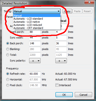

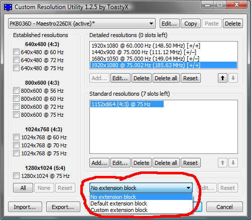

(12-09-2015 08:14 PM)sanmal Wrote:  I have 75Hz with this program, but i am not understand what exactly need choise in
-Detailed Resolution->Timing
-extension block
Now use default VGA, will buy DVI.
(Nvidia 8800GT 314,22)
Use whatever timing works. NVIDIA requires a custom extension block. You don't have to put anything in it.

work with all timings, its why i am sking:
Code:
1920x1080 @ 60.000 Hz (148.50 MHz) [+/+] <-default
1920x1080 @ 75.002 Hz (174.57 MHz) [+/-] <-standard
1920x1080 @ 75.002 Hz (185.63 MHz) [+/+] <-native
1920x1080 @ 75.001 Hz (164.61 MHz) [+/+] <-reduced
what of this more prefered for more stable (except default)?
Same for extension block, work with any of them.
