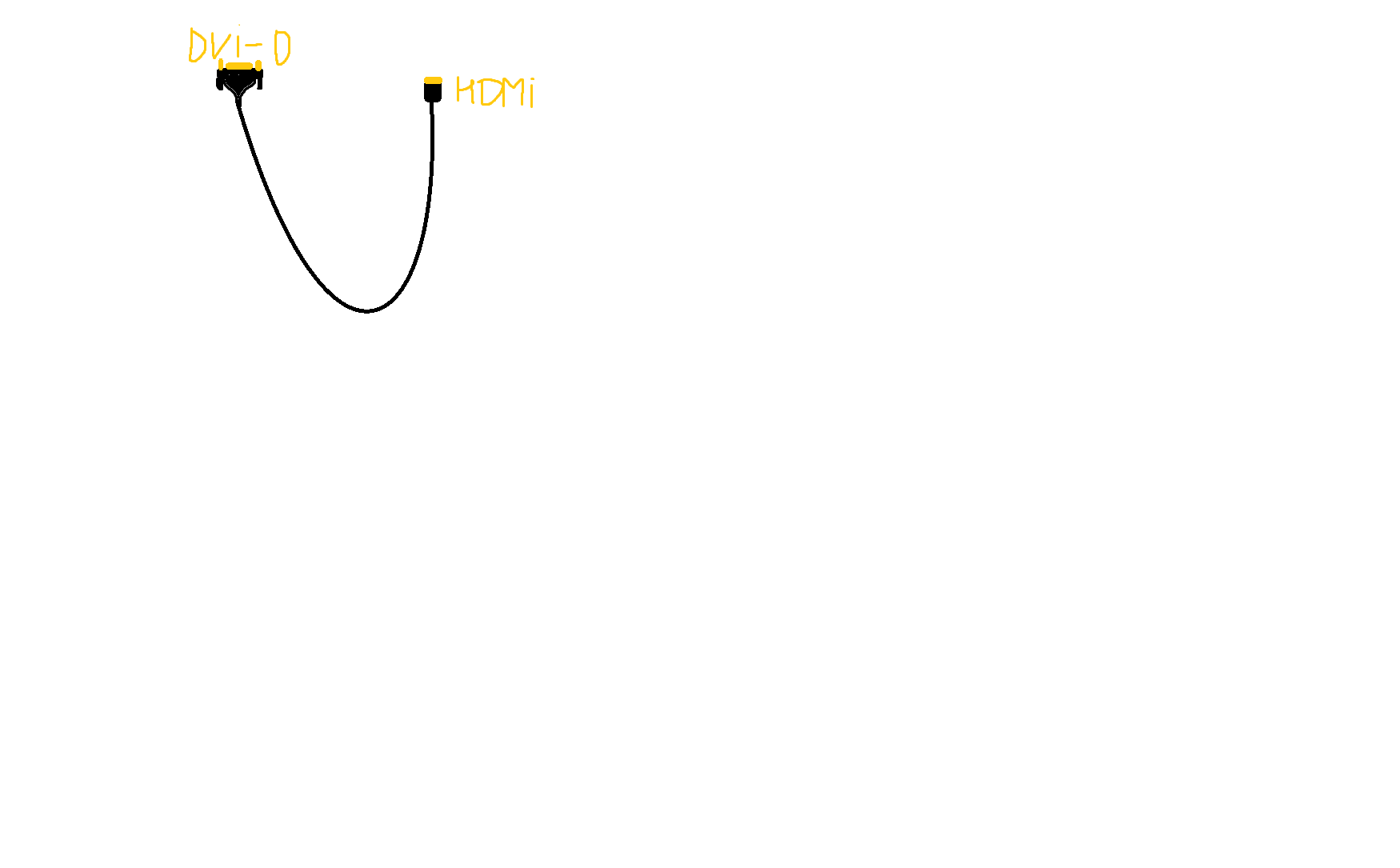

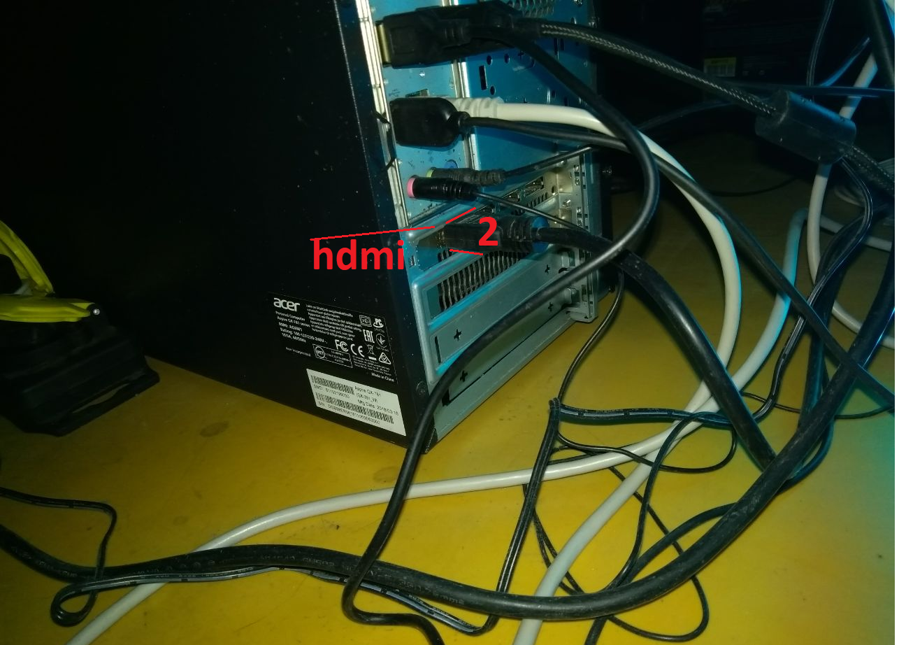

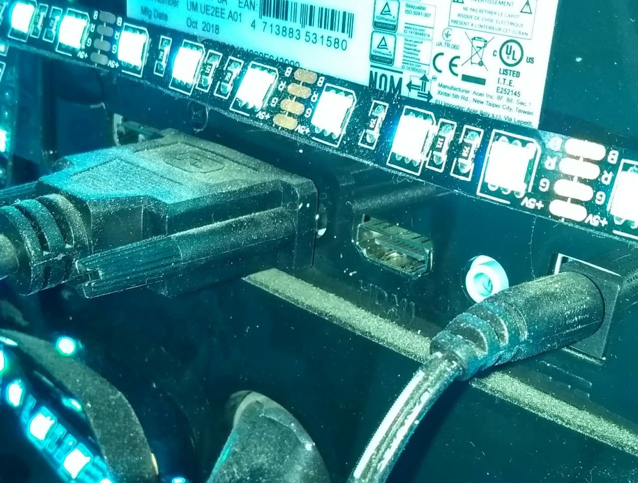

You said DVI to HDMI but your pictures show HDMI to DVI. I don't understand why you couldn't tell me this. Why can't you use HDMI? The monitor is not intended to take an HDMI signal through the DVI port.

(12-09-2020 03:01 PM)ToastyX Wrote:(12-09-2020 11:57 AM)ecosgrab78 Wrote:You said DVI to HDMI but your pictures show HDMI to DVI. I don't understand why you couldn't tell me this. Why can't you use HDMI? The monitor is not intended to take an HDMI signal through the DVI port. Mate, this is a cable from the monitor with dvi-d to HDMI to the card. (12-09-2020 06:45 PM)ecosgrab78 Wrote:(12-09-2020 03:01 PM)ToastyX Wrote:(12-09-2020 11:57 AM)ecosgrab78 Wrote:You said DVI to HDMI but your pictures show HDMI to DVI. I don't understand why you couldn't tell me this. Why can't you use HDMI? The monitor is not intended to take an HDMI signal through the DVI port. |

(12-09-2020 06:45 PM)ecosgrab78 Wrote: Mate, this is a cable from the monitor with dvi-d to HDMI to the card.The output goes from the card to the monitor. I will have an update soon, but the monitor is not designed to run at 1920x1080 @ 144 Hz with a single-link signal on the DVI port. HDMI wouldn't need the patcher, but I just found out the monitor only supports 120 Hz with HDMI. It's really meant to be used with DisplayPort. You're also missing out on FreeSync by not using DisplayPort. If your card won't handle DisplayPort correctly, then something is wrong with the card. It should just work, and you wouldn't need the patcher with DisplayPort either. |
