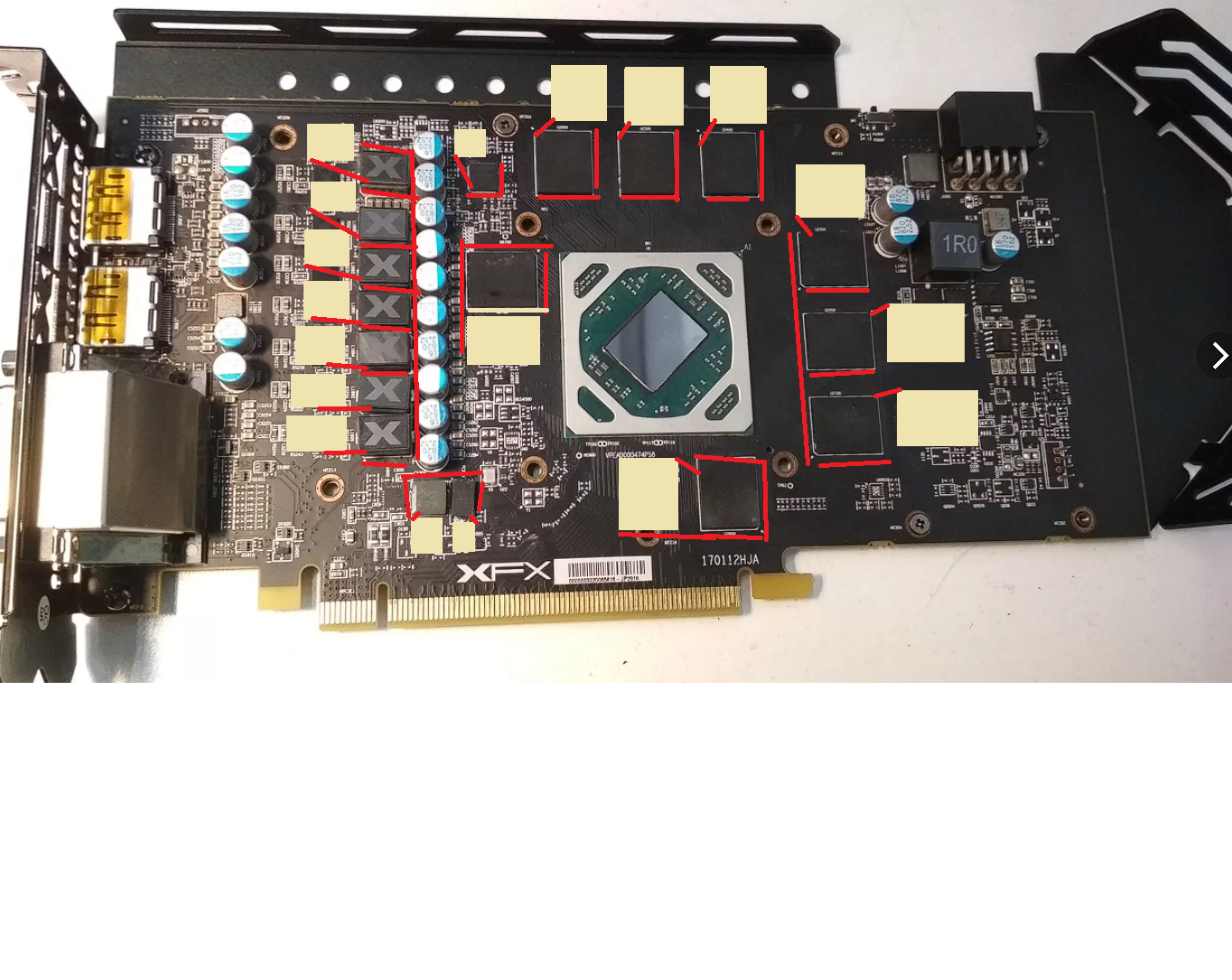

(12-04-2020 08:35 PM)Jack7v7 Wrote:(12-04-2020 10:53 AM)ecosgrab78 Wrote:(12-04-2020 03:12 AM)Jack7v7 Wrote: Hi, I'm having issues with my Rx 570 8gb graphics card with the new software : 20.11.3 when it randomly crashes my screen with a blue screen error saying VIDEO_TDR_FAILURE (atikmdag.sys). I searched online and found amd/ati pixel clock patcher. When I tried to use this patcher it showed that HDMI-DVI limit in which it said "not found" but everything else was "already patched". After I patched it I restarted my pc and now the software still struggles with the issue I had before, randomly blue screen crashing and also showing (atikmdag.sys) error. How do I fix this? On the 5th day of work, very stable version 20.11.1 : D, so check the video card for the presence of thermal paste (thermal paste for the graphics chip of the video card processor) and thermal pads, it needs to be changed every year. |

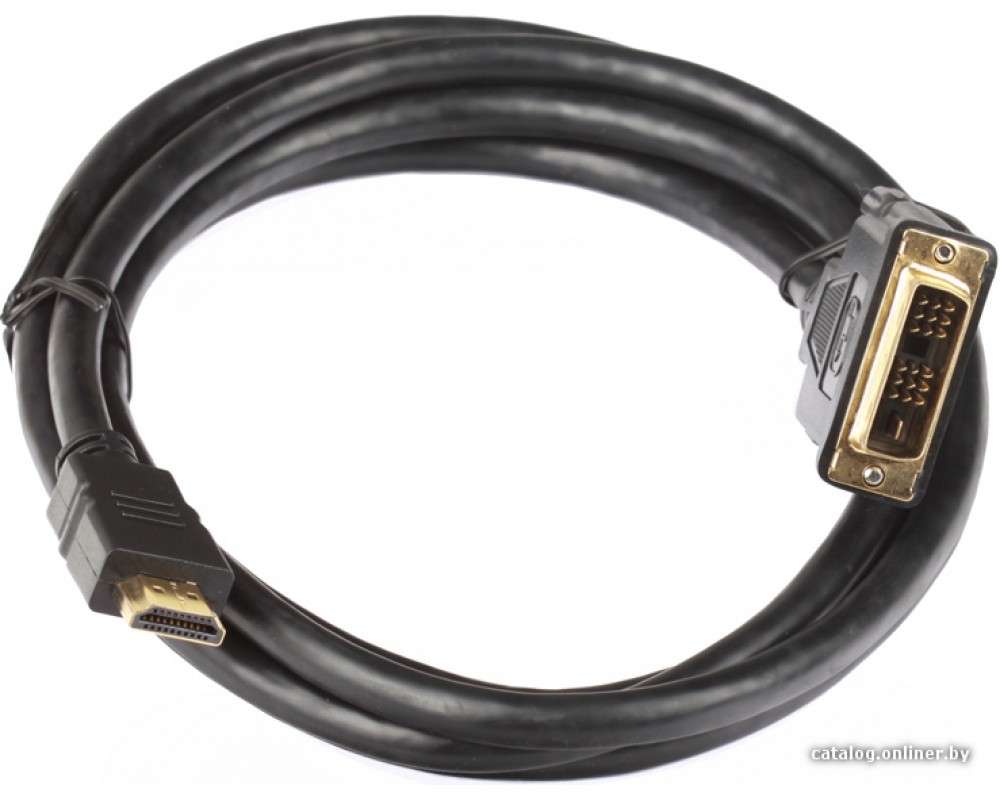

(12-06-2020 06:34 PM)ToastyX Wrote:(12-06-2020 06:25 PM)ecosgrab78 Wrote: oh sorry, i forgot to check the post, i use 144 hertz,What monitor and GPU? Are you using HDMI or DVI? Any adapters? amd rx580 video card, cable! dvi-d to HDMI (NOT ADAPTER) monitor acer ED242QRA 144 hz (12-06-2020 07:25 PM)Jack7v7 Wrote:(12-05-2020 04:14 AM)ToastyX Wrote:(12-04-2020 08:35 PM)Jack7v7 Wrote: Thanks a lot for the reply and help. I did exactly what you told me to and it seemed to work fine but now while ingame the game crashes because of the radeon software crashing and then it says "The display driver has stopped working and recovered" or something like that. It does not do the blue screen error anymore so I can still use my pc but just crashes the game and software, the software is restarted so I can still open it after the crash. The radeon software just randomly crashes causing my pc to freeze with a black screen for a bit and also Pressing ALT + R ingame also freezes and crashes the game. However I have discovered that without manually downloading the Rx 570 drives, the drives are automatically downloaded to 17.1.1 and after using the patcher it works like a charm without any issues. Is there a way I can use 20.11.1 without the freezes and software crashes? Or should I stick to 17.1.1?Something is wrong with your card. The patcher isn't for fixing crashes. This sounds like a hardware problem. Smile very glad that you helped |

(12-06-2020 06:34 PM)ToastyX Wrote:(12-06-2020 06:25 PM)ecosgrab78 Wrote: oh sorry, i forgot to check the post, i use 144 hertz,What monitor and GPU? Are you using HDMI or DVI? Any adapters? amd rx580 video card, cable! dvi-d to HDMI (NOT ADAPTER) monitor acer ED242QRA 144 hz |
