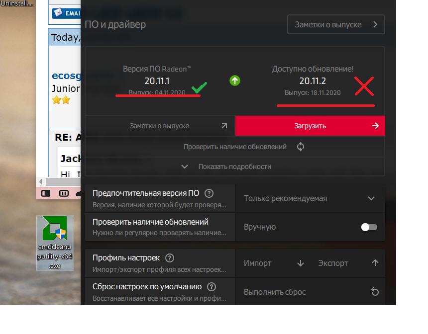

(12-04-2020 03:12 AM)Jack7v7 Wrote:  Hi, I'm having issues with my Rx 570 8gb graphics card with the new software : 20.11.3 when it randomly crashes my screen with a blue screen error saying VIDEO_TDR_FAILURE (atikmdag.sys). I searched online and found amd/ati pixel clock patcher. When I tried to use this patcher it showed that HDMI-DVI limit in which it said "not found" but everything else was "already patched". After I patched it I restarted my pc and now the software still struggles with the issue I had before, randomly blue screen crashing and also showing (atikmdag.sys) error. How do I fix this?
amdcleanuputility x64
use this program to remove the GPU driver, and install the old version for example, 20.11.2, 20.11.1
then after installing the old version of the driver, patch the driver signature again and reboot.

Thanks a lot for the reply and help. I did exactly what you told me to and it seemed to work fine but now while ingame the game crashes because of the radeon software crashing and then it says "The display driver has stopped working and recovered" or something like that. It does not do the blue screen error anymore so I can still use my pc but just crashes the game and software, the software is restarted so I can still open it after the crash. The radeon software just randomly crashes causing my pc to freeze with a black screen for a bit and also Pressing ALT + R ingame also freezes and crashes the game. However I have discovered that without manually downloading the Rx 570 drives, the drives are automatically downloaded to 17.1.1 and after using the patcher it works like a charm without any issues. Is there a way I can use 20.11.1 without the freezes and software crashes? Or should I stick to 17.1.1?
On the 5th day of work, very stable version 20.11.1
: D, so check the video card
for the presence of thermal paste
(thermal paste for the graphics chip of the video card processor)
and thermal pads, it needs to be changed every year.
