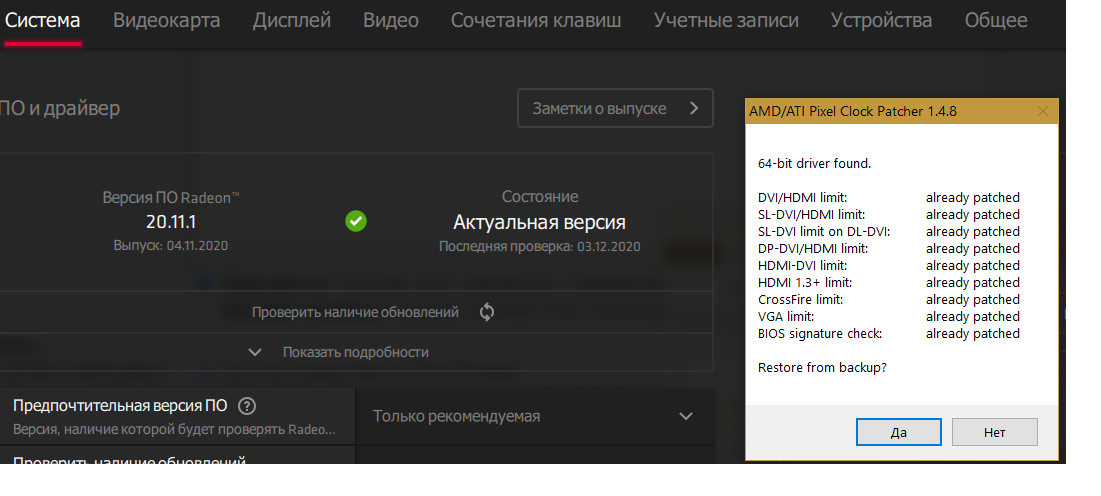

12-03-2020, 08:44 AM (Last edited: 12-03-2020, 08:45 AM by ecosgrab78)
Post: #1028
Revision Number
Adrenalin 2020 Edition 20.11.3 Optional
File Size
458 MB
Release Date
30/11/2020
the patcher does not allow changing the update frequency, I rolled back the amd version to 20.11.1 everything works again.
12-03-2020, 01:52 PM
Post: #1029
(12-03-2020 08:44 AM)ecosgrab78 Wrote:  the patcher does not allow changing the update frequency, I rolled back the amd version to 20.11.1 everything works again.
Which update frequency? What are you using the patcher for?
