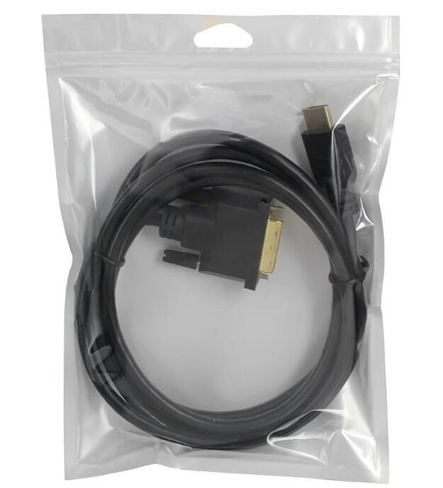

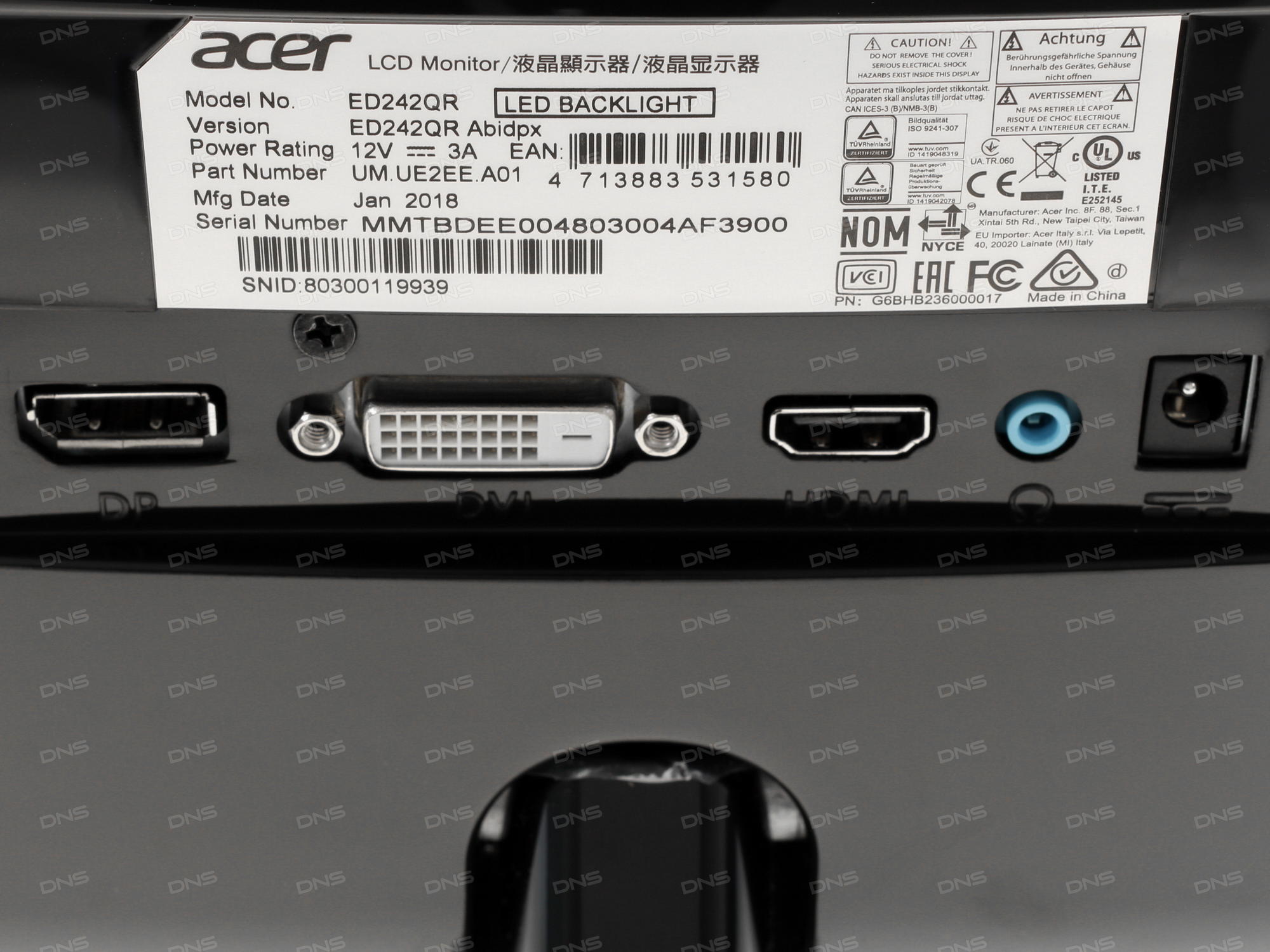

(12-07-2020 02:08 PM)ecosgrab78 Wrote:  amd rx580 video card, cable!
dvi-d to HDMI (NOT ADAPTER)
monitor acer ED242QRA
144 hz
Is that DVI on the computer's end and HDMI on the monitor's end? The cable is the same as an adapter. Why not use HDMI or DisplayPort?
why ???, the display port has already been stuck, the video card thinks that there are three monitors in the system, the desktop lights up empty without sound without shortcuts without a cursor. and where does the HDMI cable? if everything works with dvi-to HDMI.!

(12-08-2020 06:12 PM)ecosgrab78 Wrote:  why ???, the display port has already been stuck, the video card thinks that there are three monitors in the system, the desktop lights up empty without sound without shortcuts without a cursor. and where does the HDMI cable? if everything works with dvi-to HDMI.!
So is that DVI on the computer's end to HDMI on the monitor's end? If you use HDMI, you won't need the patcher.

You said DVI to HDMI but your pictures show HDMI to DVI. I don't understand why you couldn't tell me this. Why can't you use HDMI? The monitor is not intended to take an HDMI signal through the DVI port.

Mate, this is a cable from the monitor with dvi-d to HDMI to the card.

Mate, this is a cable from the monitor with dvi-d to HDMI to the card. you see it? : D
12-09-2020, 10:22 PM
Post: #1046
(12-09-2020 06:45 PM)ecosgrab78 Wrote:  Mate, this is a cable from the monitor with dvi-d to HDMI to the card.
The output goes from the card to the monitor. I will have an update soon, but the monitor is not designed to run at 1920x1080 @ 144 Hz with a single-link signal on the DVI port. HDMI wouldn't need the patcher, but I just found out the monitor only supports 120 Hz with HDMI. It's really meant to be used with DisplayPort. You're also missing out on FreeSync by not using DisplayPort. If your card won't handle DisplayPort correctly, then something is wrong with the card. It should just work, and you wouldn't need the patcher with DisplayPort either.

very good. but it cannot be that the monitor is not designed to operate at 1920x1080 @ 144Hz with a single link signal on the DVI port.

the question is ripe, tell me maybe the display port should work alone and you need to disconnect other ports from the video card ?.
because still the video card, thinks that I have three monitors, but by the way there is sound. Dodgy
three times I tried, but I did not pull out the plugs, but changed the signal source in the monitor to the display port. can you tell me? Huh

my god, thank you buddy the display port works fantastic thanks a lot for the help!. I'm 25 I feel like a grandfather.
