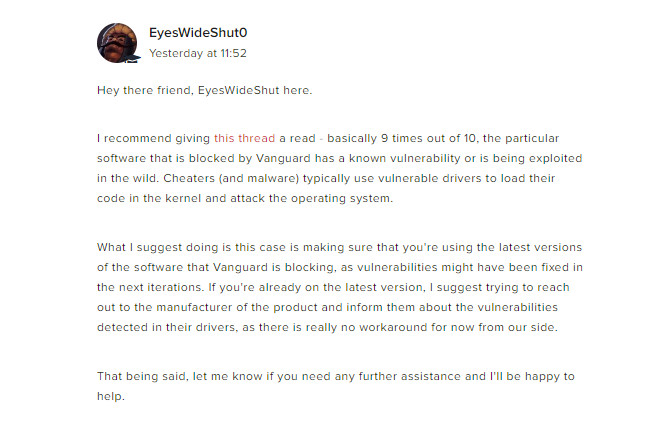

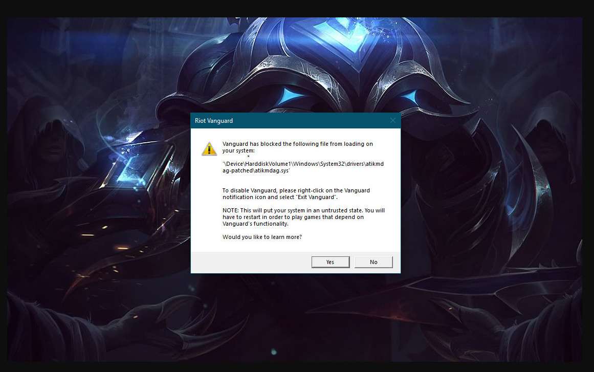

06-11-2020, 02:03 AM
Post: #998
hi
thank you for thae hard work
i just want to asking u for fix a new problem
i dont know if u know the new riot game called valorant it does contain anti cheat system which blocks ur patcher atikmdag.sys i contact with riot they told me they cant do anything by them its up to program made if he can fix the problem like detecting it like a cheating program ill upload photo to see what they say so u can understand
so please if u can fix the problem and what causing it i can play valorant at all
06-11-2020, 01:19 PM
Post: #999
(06-11-2020 02:03 AM)zooom Wrote:  hi
That's a bullshit answer. I can't do anything. They're the ones blocking it.
