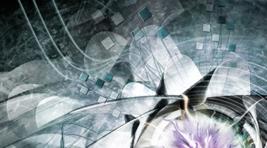

Hello i have a rx 470D that i modded to a 470 at the time i followed these steps https://www.techpowerup.com/228536/amd-b...3#comments but after awhile the drivers update then if i run the patch again the colors on my screen gets messed up, will this fix the problems i'm having and if not do you have any tips or advice for me.

(04-20-2022 05:32 PM)ooadri Wrote: Hello i have a rx 470D that i modded to a 470 at the time i followed these steps https://www.techpowerup.com/228536/amd-b...3#comments but after awhile the drivers update then if i run the patch again the colors on my screen gets messed up, will this fix the problems i'm having and if not do you have any tips or advice for me.What do you mean by the colors get messed up? Try renaming the file to atikmdag-patcher-bios.exe to only patch the BIOS signature check and not any of the pixel clock stuff if you don't need that. |

(04-20-2022 05:49 PM)ToastyX Wrote:(04-20-2022 05:32 PM)ooadri Wrote: Hello i have a rx 470D that i modded to a 470 at the time i followed these steps https://www.techpowerup.com/228536/amd-b...3#comments but after awhile the drivers update then if i run the patch again the colors on my screen gets messed up, will this fix the problems i'm having and if not do you have any tips or advice for me.What do you mean by the colors get messed up? Try renaming the file to atikmdag-patcher-bios.exe to only patch the BIOS signature check and not any of the pixel clock stuff if you don't need that. the colors look like the pic attached. |

(04-20-2022 05:49 PM)ToastyX Wrote:(04-20-2022 05:32 PM)ooadri Wrote: Hello i have a rx 470D that i modded to a 470 at the time i followed these steps https://www.techpowerup.com/228536/amd-b...3#comments but after awhile the drivers update then if i run the patch again the colors on my screen gets messed up, will this fix the problems i'm having and if not do you have any tips or advice for me.What do you mean by the colors get messed up? Try renaming the file to atikmdag-patcher-bios.exe to only patch the BIOS signature check and not any of the pixel clock stuff if you don't need that. did what you said everything seem fine but i'll have to give it a couple days |
