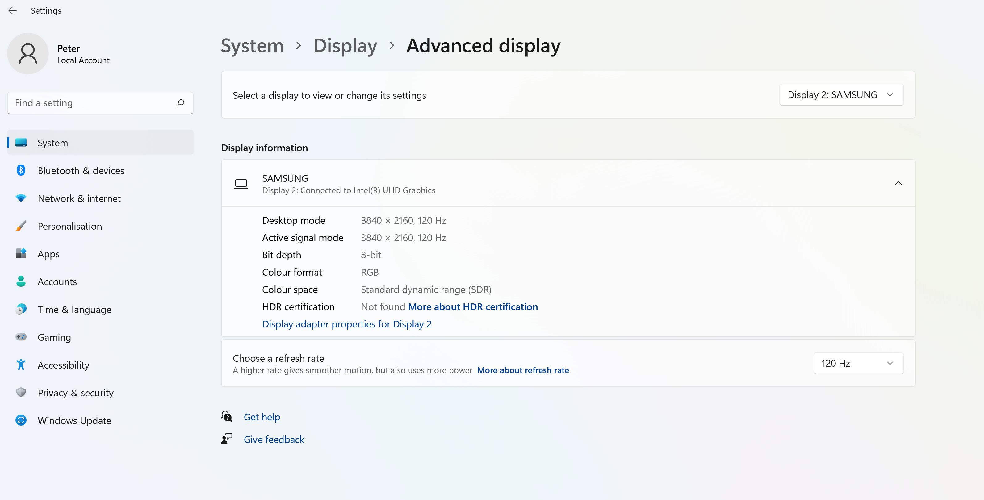

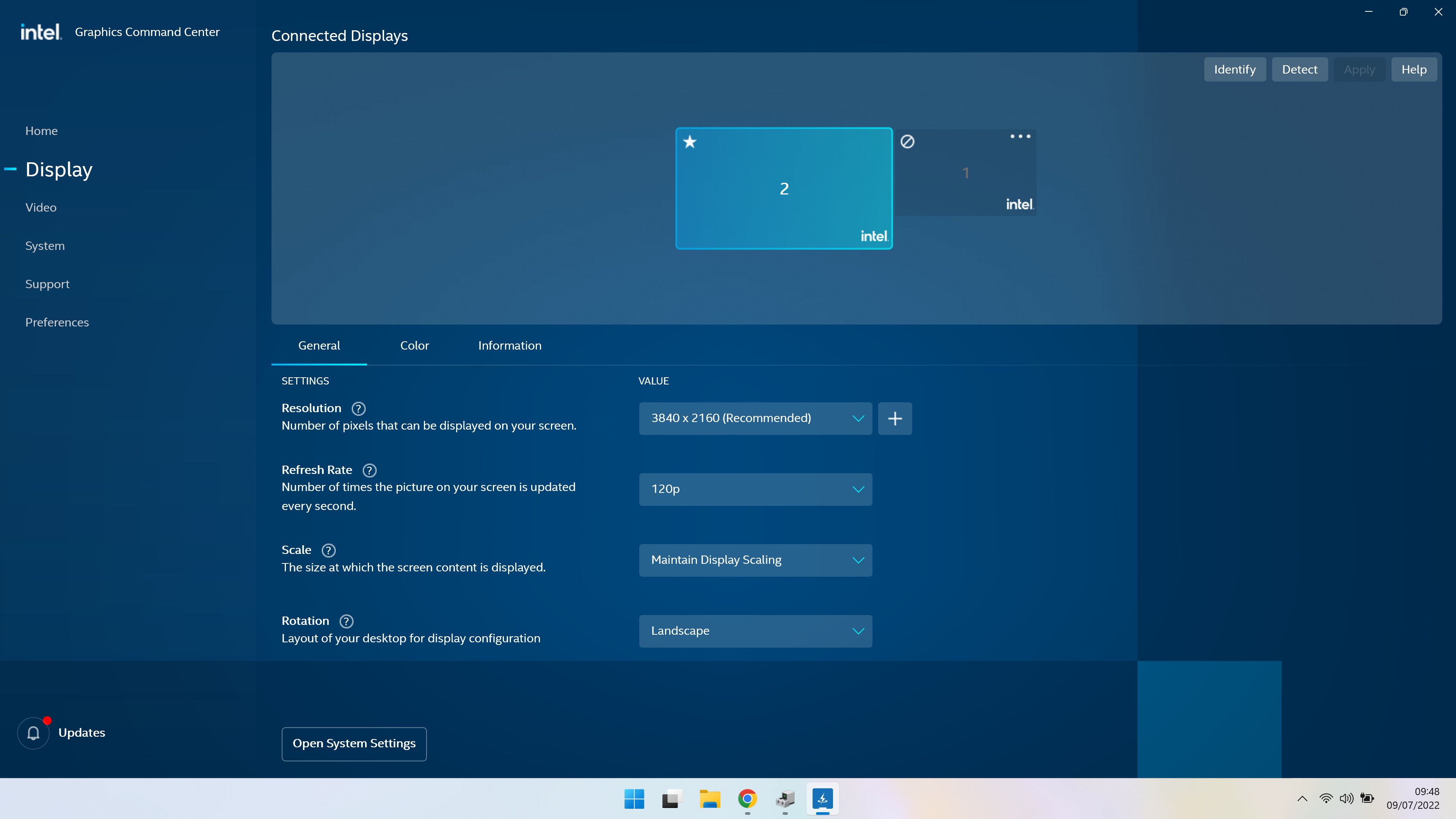

07-09-2022, 08:16 AM
(Last edited: 07-09-2022, 09:05 AM by IIISi Z16 HF LE)
Post: #6758
Guyyyyz
Iiiiiiiiiitttt woooooooorrks I just used HDMi 4 port and it suddenly started to work !!! aaaaaaaaaaaaaaaaaaaaaaa But I think I have tried it I don't remember I had it connected in HDMi3 becsue my desktop PC perfectly works via HDMi 3 4k@120 vrr But one thing I did yesterday I have installed official IIISi drivers from my support website of laptop and driver is from 22.3.2021 Before I have used that stupid intel driver support assistand and it updated to version 30 which is probably bad I will try it with that driver and see if they aded restriction ! When I turn HDR on it will revert back to 60 Hz but I don't use HDR so that's good ! BUT DAMN I AM HAPYYYYY !!
