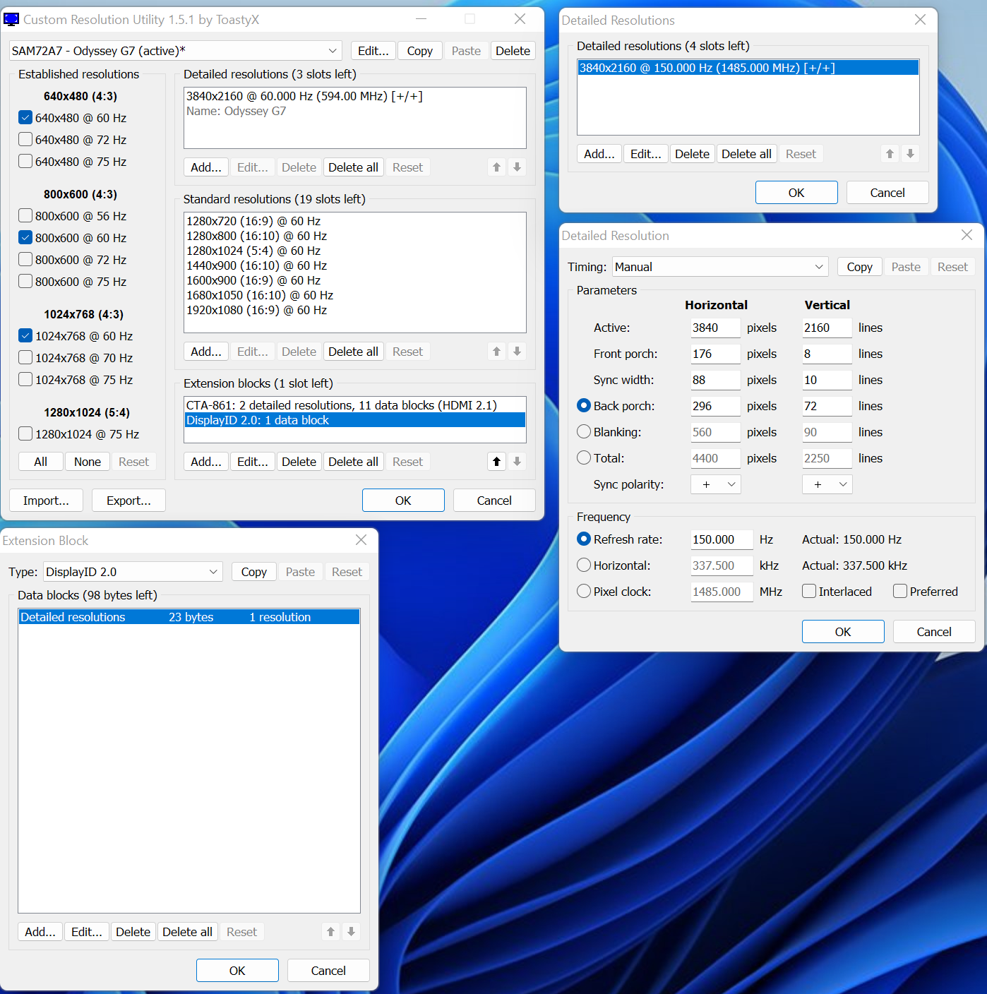

(07-08-2022 09:51 PM)ToastyX Wrote:  Try switching back to 120 Hz mode. Then edit the extension block and delete the "Extension override" data block. That will give you 3 bytes left. Then you can add a DisplayID extension block and try higher refresh rates in there.
No dice - I edited the CTA-861 as you suggested and got the 3 bytes left, but adding the DisplayID block (tried both 1.3 and 2.0) didn't do anything (closed CRU, restarted display driver, checked monitor properties, NVidia control panel, and display settings for a new entry but nothing shows up).
Attaching a screen cap with the full set of settings for the DisplayID block in case there's some user error here.

(07-08-2022 10:35 PM)NJDeac Wrote:  No dice - I edited the CTA-861 as you suggested and got the 3 bytes left, but adding the DisplayID block (tried both 1.3 and 2.0) didn't do anything (closed CRU, restarted display driver, checked monitor properties, NVidia control panel, and display settings for a new entry but nothing shows up).
You're not doing anything wrong. There's something different about the monitor and the way NVIDIA's driver handles it. Try adding 3840x2160 @ 55 Hz to see if it shows up. Just want to see if it's ignoring any change.
55 worked! I also tested various increments and everything worked up to 145. 146 and higher all failed.

(07-09-2022 12:32 AM)NJDeac Wrote:  55 worked! I also tested various increments and everything worked up to 145. 146 and higher all failed.
When you say failed, do you mean the driver doesn't add it? Then it must be some pixel clock limit. 40 Gbps is supposed to allow at least 1485 MHz, but it sounds like you're getting around 1440 MHz, which doesn't make sense for HDMI 2.1. You can still get 150 Hz under 1440 MHz if you try the different timing options.
