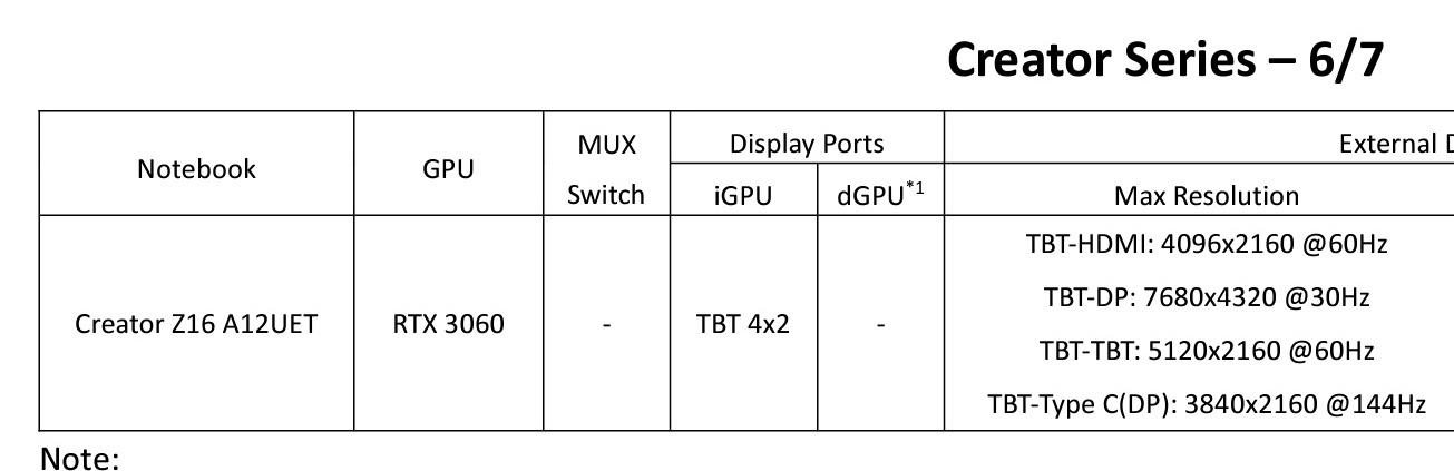

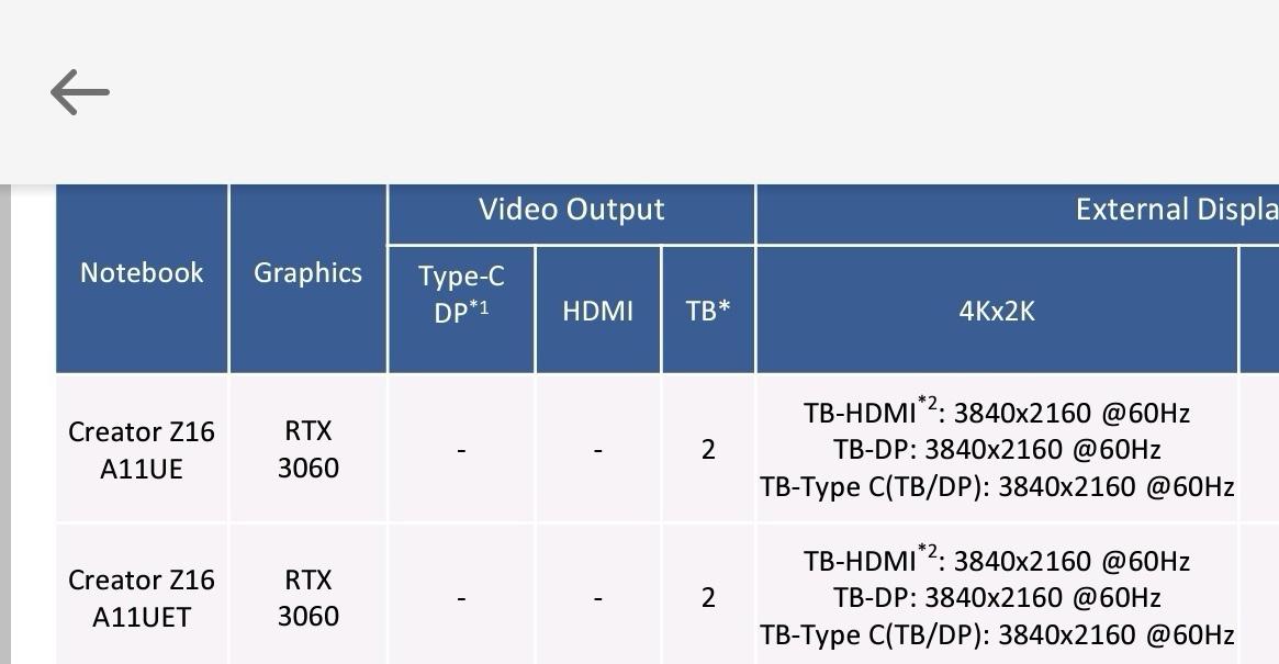

DisplayPort/USB-C adapter is less than HDMi2.1?? Really ?? I thought using thunderbolt 4 port on todays laptops is best connector surpassing HDMi 2.1 and USB4. Intel claiming that all connections are implemented in to tb4 .
Ma I missing something ?
According Intel it supports 8k@60 which means 4k@120 should work as 8k@60 is more bandwidth (please see the pics)

But there is not possible to set color formats ,dynamic ranges et in crappy Intel command center.. They stated that dongles and adapters are not supported.. and here the problem lies . they even blcking custom resolutions settings.
That's why with nvidia c panel it works.. You can configure there with ease..
If we could hack old intel graphic control centre ? I can't run it ..
I think no matter what I configure in your soft , it will be ignored by intel ! gpu and its softare in windosws
We need to contact microosoft to add custom resolutions implementing into windows 11 display settings
